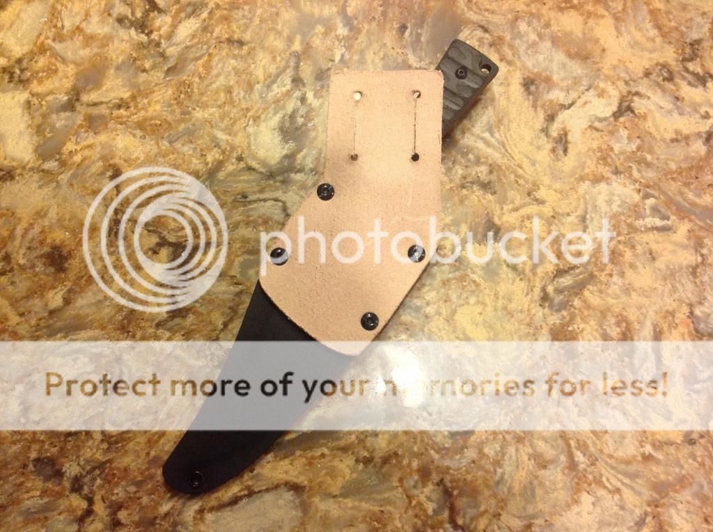

I like to use leather for the belt loops...
I am really loving the hybrid Kydex sheath with a leather belt loop. Its sort of become my trademark style. This is a new design of loop for me. I took the idea from the old kbar leather sheaths.

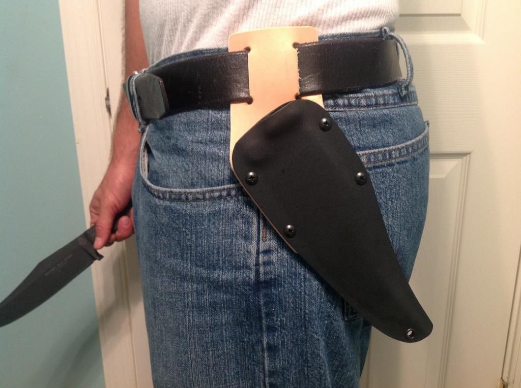

Here is the cross-draw belt loop I made for the Tops War Bowie sheath...
That knife is bananas. At first I thought the sheath was oddly shaped but it makes sense. Cool rig.
I think the press is very well priced if you can set snaps and use it as a makers mark press as well. :)
