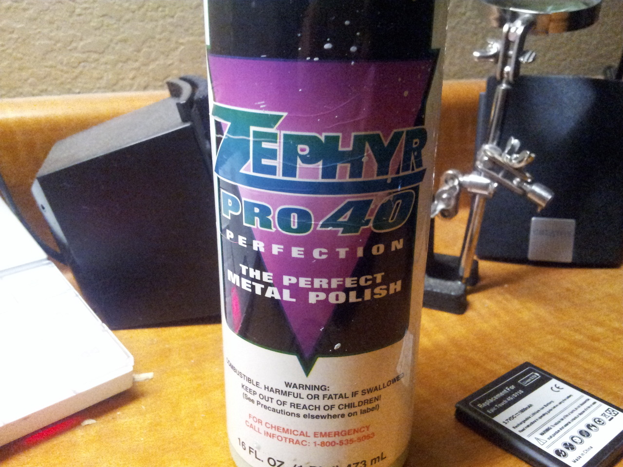

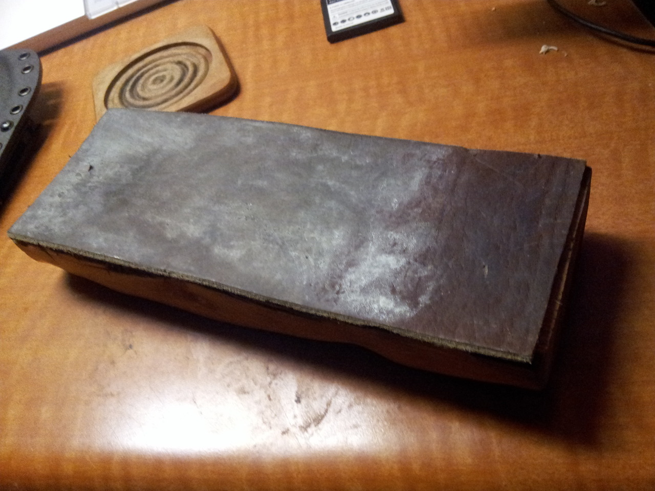

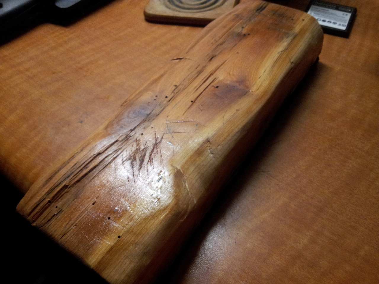

Mine:
A block of redwood with some leather on it and some Zephyr Pro 40 on about 80% of it, and a superfine diamond protective polish on the bare looking end (it's just called Diamond Shield, and it comes in an aerosol can).
Febeleh...educate me if you could please... do you apply Zephyr Pro 40 right before you strop? Or do you let dry a little then strop..

Cool. The Zephyr is put on according to need. I let it build up a dry layer when I am just doing simple maintenance stropping, to fix an edge from relatively light use, for less mess. If I was out earlier that day, and I was chopping down a small forest, I would put some more on there and strop while the polish was still wet. It just seems to polish more, and hone the edge much faster. If the damage was really bad (small chips, full on edge rolling, not often with a Becker, but still), then I will fix up the edge with a bit of 1000 grit sandpaper. I would like to know where to purchase higher grits, any recommendations?

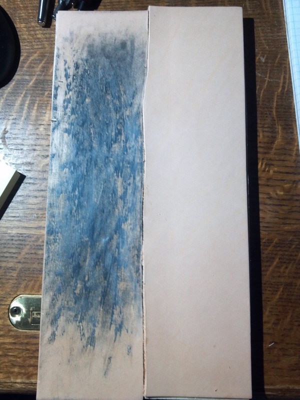

These are my first and only strops. I bought some fine stropping leather online and cut it to fit on some scrap wood. I use Flexcut Gold as a compound, but I do need something a bit finer.

Nice strop man! Get some zephyr, it gets easy razor edges.

I've never seen the Zephyr stuff before. If it works that well, then I guess I must acquire it.
Yeah. My dad is a truck driver, and when he was delivering to the place that ordered it (the company is based in California, so it might be a bit of a somewhat local thing), they gave him a bottle. He said that ordinarily the stuff is sort of expensive. It is designed for automotive chrome, I believe. So, not only will you get to use it for that, you'll get a big enough bottle to polish all sorts of things (and if you're anything like me, you'll be tempted to just go putting mirror polishes on everything, as once you can give a Becker even a rudimentary polished edge, all lesser steels are a snap to finish perfectly. Nibs are also something that can be used (though I'm sure most strops can be used for that)!
