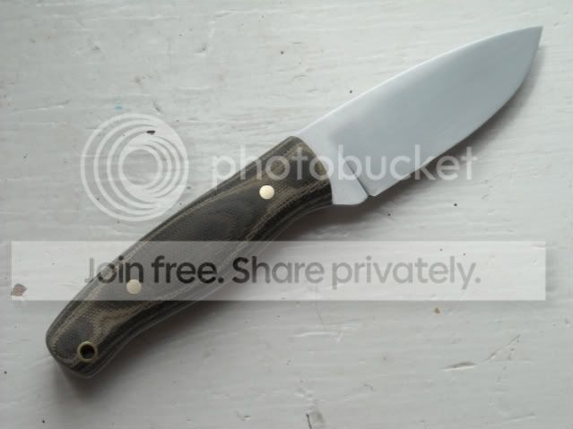

its really fun to do here is one I made recently with olive and tan canvas
