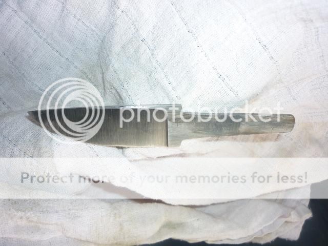

Here is my trial grind. It's my second try on this machine.. first I won't show :D. It's almost free hand, I used a tool similar to Bruce Bump's grinding jig for plunge cut. Mind you, blank was a lot bigger when I started :o :D

A 115 mm drive wheel is about 4 1/2 inches and on the surface feet per feet calculator online at 3800 rpm it delivers 4477 surface feet per minute which is pretty fast. Larry
Thanks mr. Bump :)
Larry, so my math was good.. 75 FPS times 60 gives 4500. The controls for the motor are rigged in a way that every time I turn on the machine, it goes from the slowest speed (I don't have the means to measure that, but I will guess 300-400 RPM) and then I can speed it up. Variable speed is really a good thing.. I know that this machine will be a huge improvement for me, till now I had small hand held sander witch I was turning upside down and held in a vise :rolleyes: this is a whole new level :)
