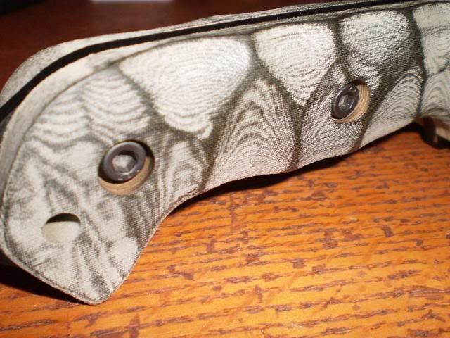

Homemade BK-7 scales
Those look great how did you make them?

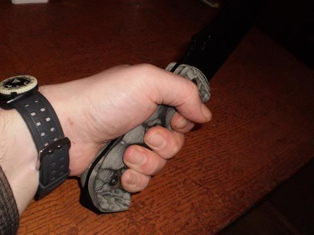

Thanks for all the compliments guys. I used the original scales as a template, cut out the shape on a band saw then shaped them with a belt sander. I've rescaled a few knives before but this is the first time I've tried doing the carved/sculpted look.
Everytime I pick the knife up now all I see is the owl...
Here's a couple more pics. One in the hand and one more of the owl...
Yes they are. When I bought the micarta it was advertised as black/green but obviously wasn't. I'd read on another forum that you could use Rit dye to to dye micarta and G10 so I thought I'd give it a go.

Thanks for the kind words. The micarta was 1/4 inch thick and the shaping was done with the top of a belt sander with 80 grit belts.
