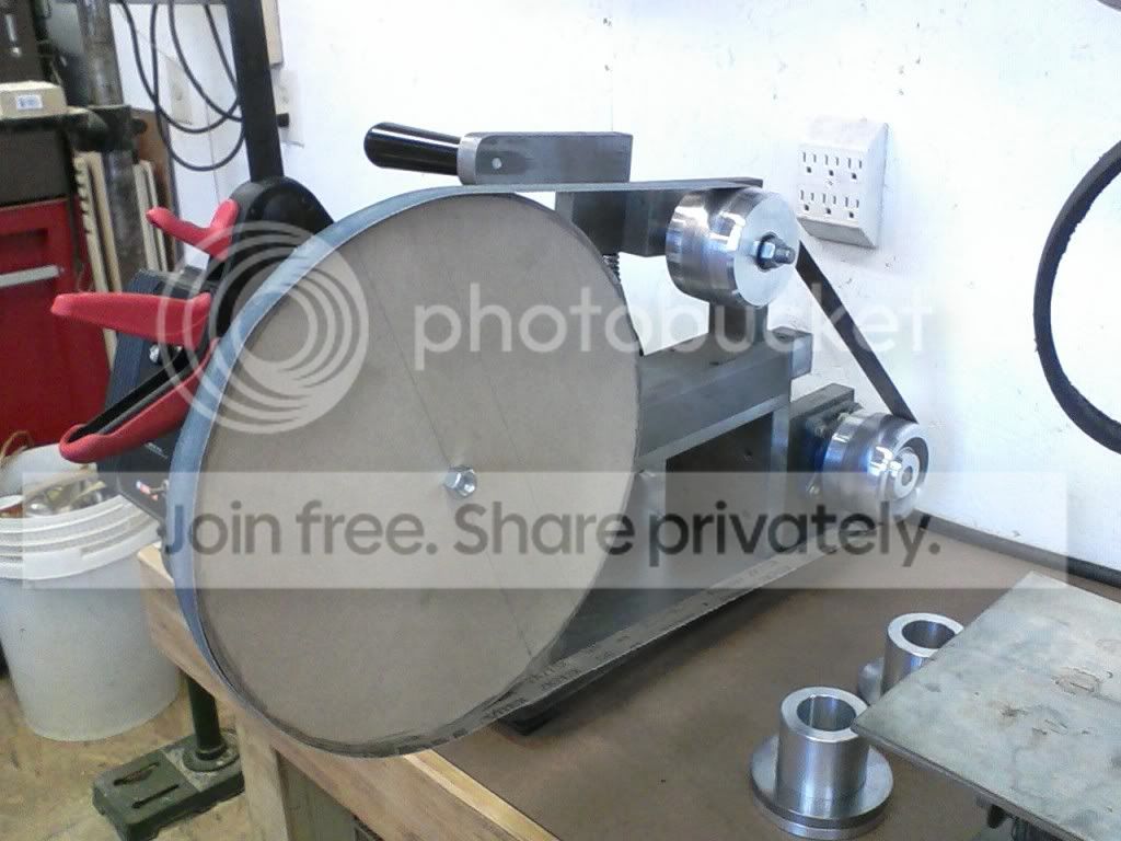

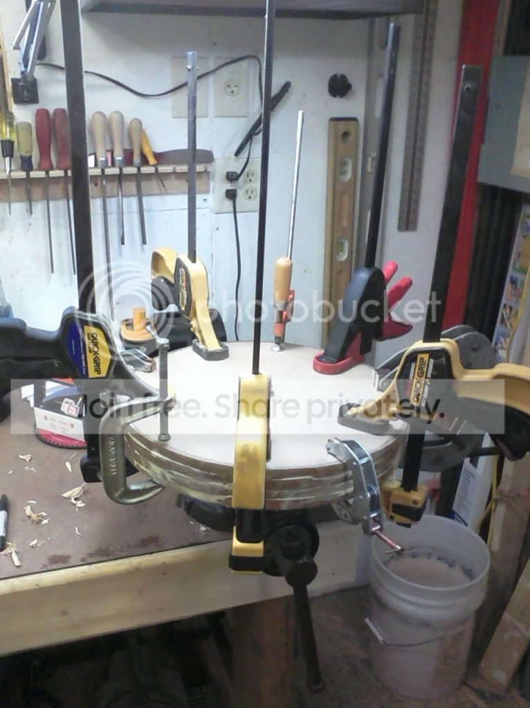

I was inspired by Michael Morris's recent videos. He used a wooden contact wheel on a few of his grinders. I'm not sure what material Michael used, but I decided to used ½" MDF to construct the wheel. I bought 1 2'x4' sheet of ½" MDF at home depot for just under $8.00.
Here is the mock up piece to check for fit.
And this is as far as I got for today. I did not get any pictures of the pieces layed out on the board, or rough cutting the circles. I imagine you all can envision that process anyways. I will leave the clamps on overnight. You can't see it in the picture but I drilled a ½" hole in the center of all 4 pieces, and ran a piece of all thread thru it to keep things in line, and act as a clamp for glueing.
More to come in the next few days.

I'm not sure of the weight yet. I am planning on the wheel being 14" I was thinking of putting leather on the contact area of the wheel anyways, now I'm glad to hear that it has been done before.

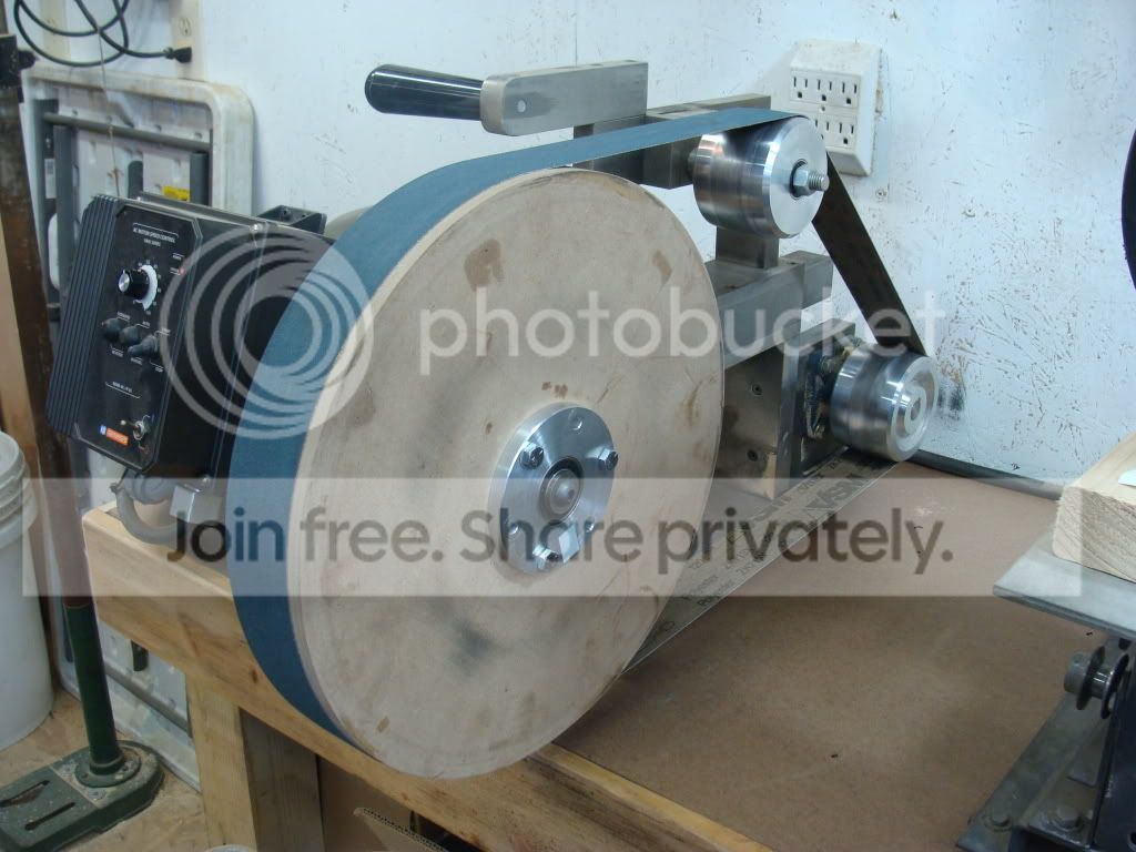

I got the wheel finished today. It runs very smooth. I checked it with a digital tachometer, and it ran smooth at 1500 r.p.m. and I am very pleased with how it turned out. I still need to get the leather, or rubber for the contact surface and she is ready for action. Now I just need to run some steel over it and see how it holds up.
Here are a few pictures of it mounted.

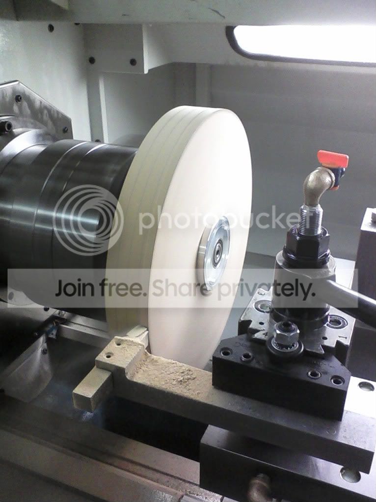

Here is an action shot of trueing the O.D.

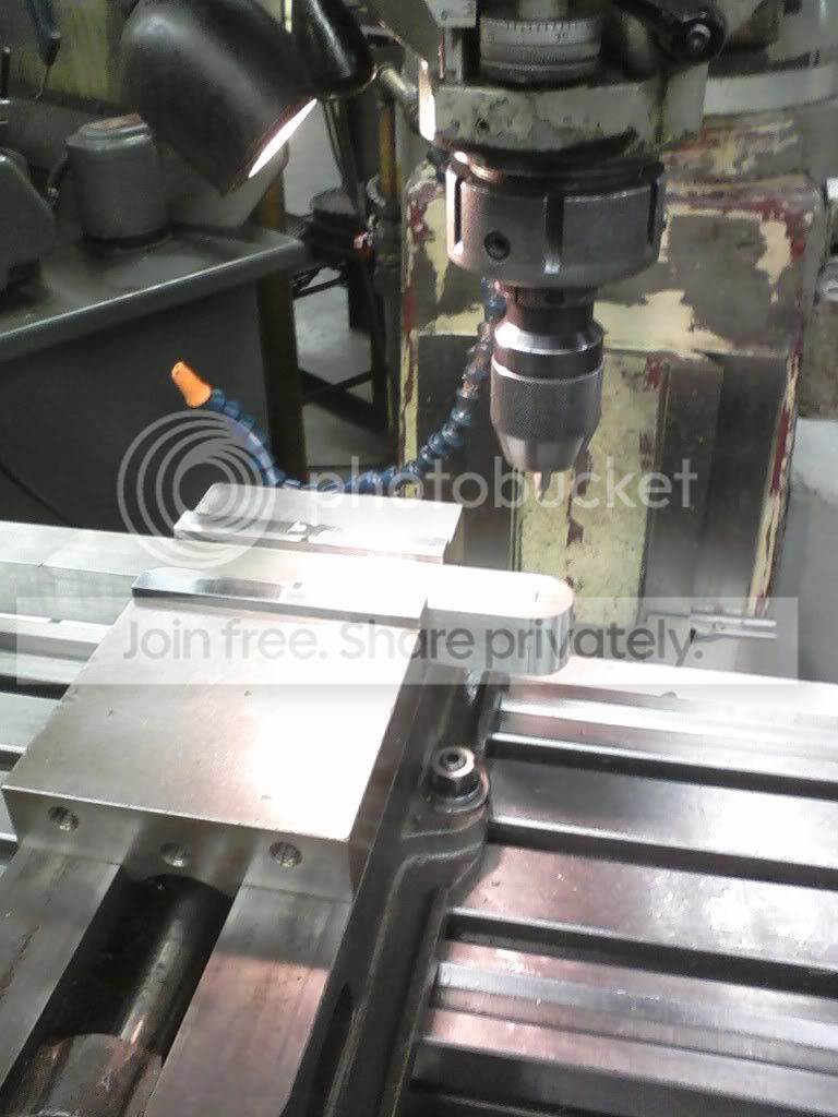

On the mill to drill and ream the axle hole

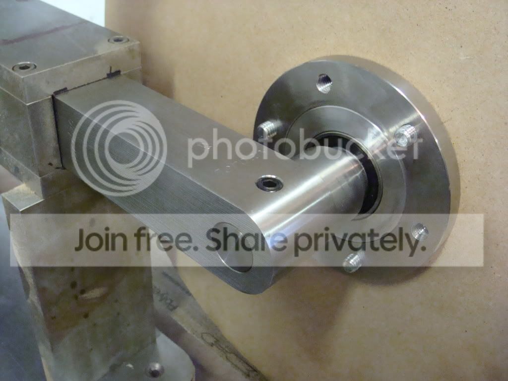

The axle is .750 diameter
The major hub diameter is 4"
That is a BEAST of a wheel! Nice job.:thumbup:

Are you holding it by the OD of the 4in hub in the lathe ? I might have to give this a go, if it all works out in the final testing.

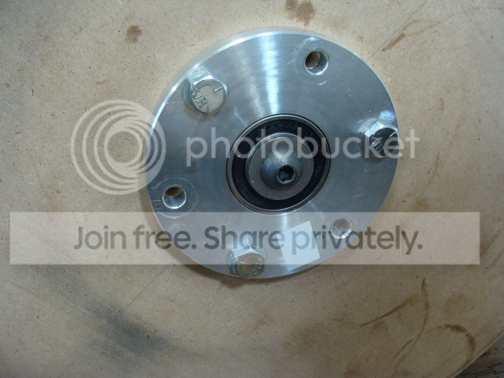

By the way, why all the extra holes ? Is there a reason you appearently started out to have a 6 bolt pattern and settles for 3 ?
Yes I am holding it by the 4" hub diameter. I indicated the I.D. of the bearing to .0005 and trued the o.d. so everything is running perfect to one another. I only had 3 bolts at home so that is why the other holes are empty. I now have the bolts trimmed to length so they don't stick out, and all holes are being used.
