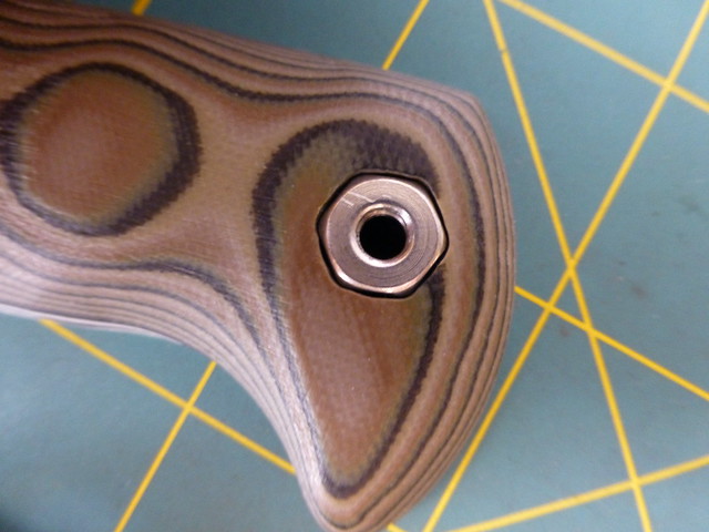

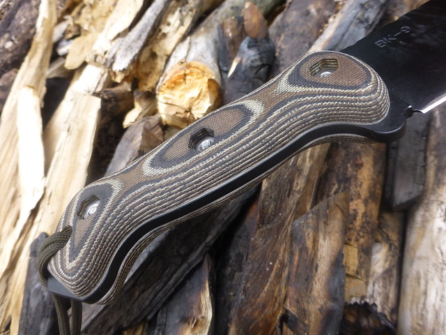

Homemade micarta slabs on my BK2!!! Woot!!!
Those look fantastic, great job!!
After some research I learned about the hot-plunge technique for cutting the hex holes. Once I was confident in my ability to do so, I went about making myself a pair.

How would I go about cutting the hex holes then? There HAS to be a better way that using a chisel?

Sorry Blackhawk, I used up all my clever on the hot-plunge. I suppose you could find a broach that would do the job.

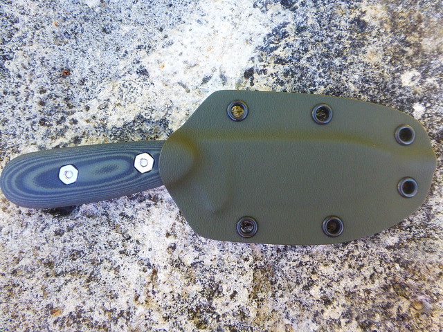

For the hex holes I use a dremel engraving bit...
With a template or just freehand? They look great.

Thanks, but what do you mean? Template for the contours or the overall shape so its flush with the tang?
I don't use any kind of template for the contours, just freehand until they feel about right. In hindsight though, these ones could have used a bit more sanding since they feel a tad blocky, kinda what I image the Camillus ergos to have been.
For the overall shape though I do use my BK-5 as a template to get the scales flush before doing the ergos.
My 5 is actually starting to wear down from accidently hitting the grinder over several sets of scales so I probably won't be making any more Becker handles in the future.

I meant template routing the hexes with the Dremel. For scales, if you wanna save your 5 (and you have a router), you can use the scale as a template and use a bearing guided bit to outline the scales:

I drill an appropriate size hole on the hex nut side of the scales (5/16" or 3/8" I think) down to where the nut will sit in comfortably, not all the way though obviously and then mark out the edges where material needs to be removed with a sharpie. From there just test fit the nut every so often to see if it will go in until you get a nice fit.
As for the router, I'm moving away from scales into my own customs so making a set of scales compatible between a whole bunch of knives isn't really important. Especially since the knife blades are cut and ground by hand so they will all be slightly different in size anyway.
A jig isn't really needed for the holes. Clamp them down and the holes will be where you want them when you drill. I also usually leave/end up with an 1/8" or so of extra material around all sides of the scales so even if the hole is slightly off you have the ability to adjust and realign it.
