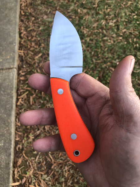

I've done it a couple of times. Really not that complicated This was made from hunter orange safety vests that I bought on clearance at WalMart.
