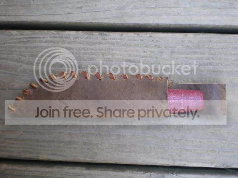

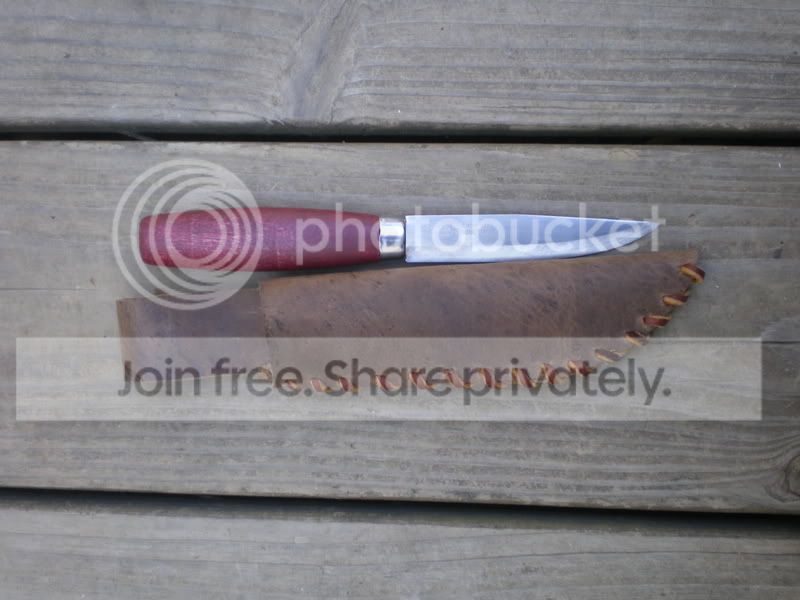

I figured you outdoors people would apprreciate this the most so I posted it here. Like most people, I love my mora but hate its sheath. I had some leather remnants from Tandy that I got to make a strop. This is my first attempt at anything like this so it is a bit crude, but it works well and turned out better than I thought it would. It is a big improvement over the plastic sheath it came with. As soon as it was finished, I already saw a couple of things that I would have changed, but you have to start somewhere. What are your opinions on this Mora sleeve?
BTW: It took me the better part of 30min. to complete, just for reference in case anyone else would like to try it.

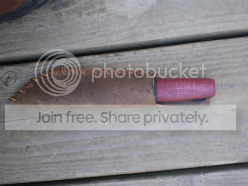

This is a pic with the liner in, I like it better without the liner, but it is nice to be able to chose. I havn't cut the top off the plastic sheath yet, but I it would look better if I did.
Go ahead, be brutal!:D

How is the retention without the liner?

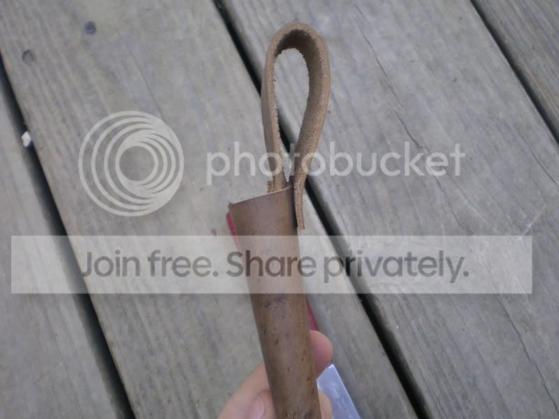

How is the belt loop attached?
If you need the liner for retention you could cut off the top so that only a small portion slips over the handle, just enough to hold it.

that looks great. alot better than my first. if it was me, id keep the liner in so that over time your blade doesnt cut through the lace. you know, that stuff always happens at the worst times. how is the loop attatched?
Very nice.. Very nice, if there is no liner be careful I made a similar sheath for a mora and sliced it open at the lacing when over zealously puttting it away
The loop is attached with 50lb. test fishing line stitched in a criss-cross pattern. The retention is adequate without the liner, I can turn it up-side down and shake it gently and it doesn't fall out. I don't mind if it cuts the lacing, also the blade doesn't even touch the stitching at the bottom, I am not too worried about it. Thanks for the kind words everyone. I would be interested to see how yours turned out.

One thing to help with the possibility of cut stitching, make a strip of heavy leather and sandwich it between where the sheath comes together, contact cement does really well for this. That way the blade runs along this strip instead of against the leather lace. Hope this helps. :)
