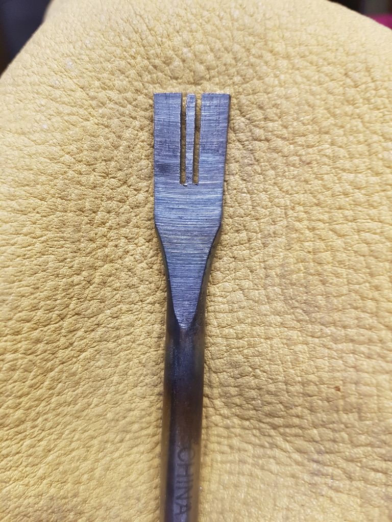

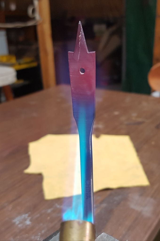

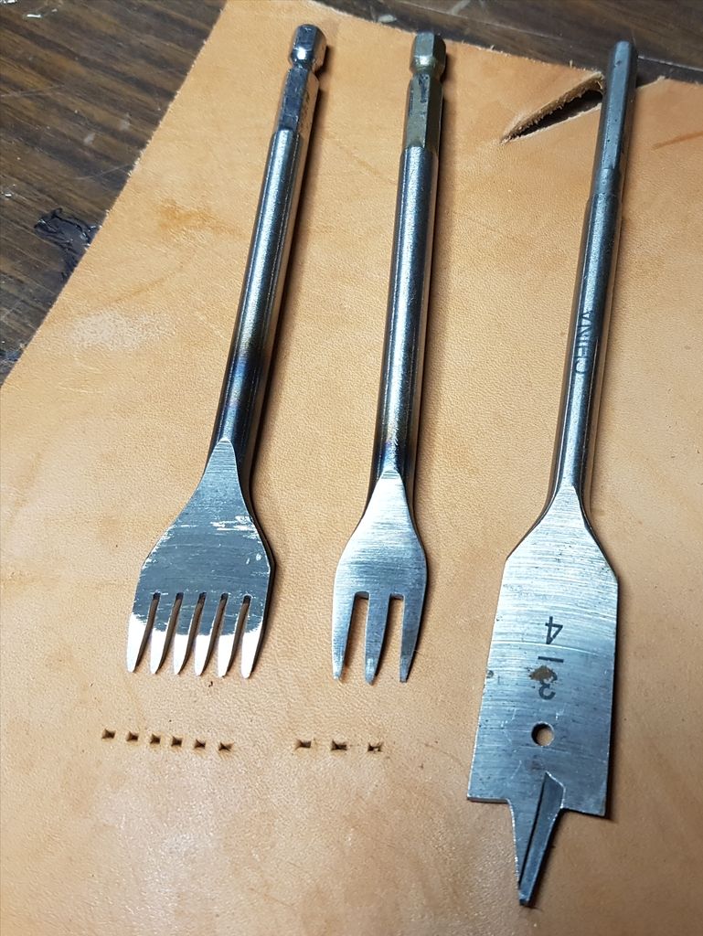

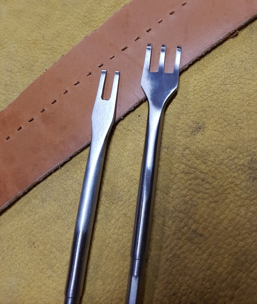

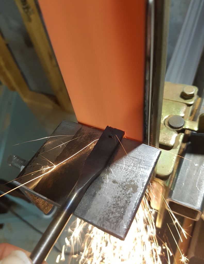

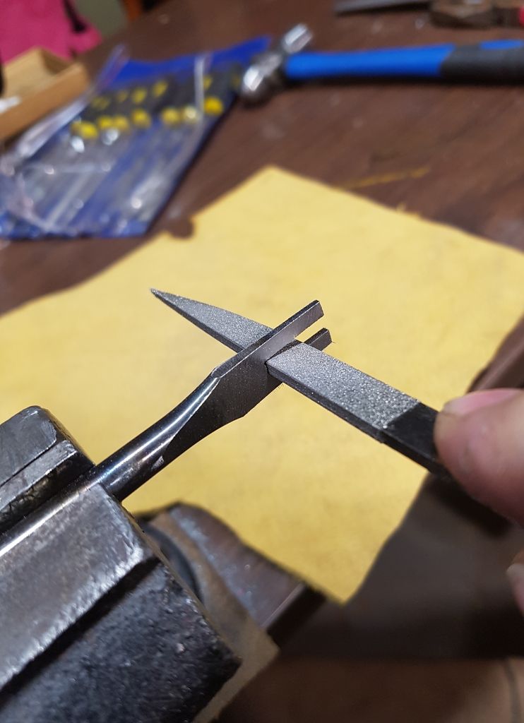

Here's an idea for anyone who wants to make their own custom pricking irons for leather work. Get yourself some cheap spade bits... Soften the end of the bit with a propane torch and then using a bandsaw and files, cut out and form the prongs. This beats the heck out of trying to make a punch out of old kitchen utensils. These spade bit punches are super strong, cheap to make and they work great!
