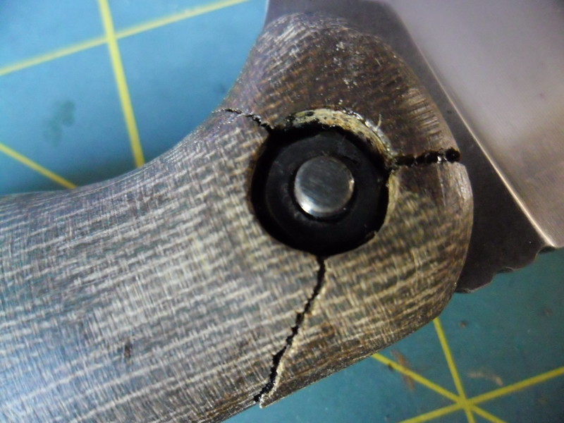

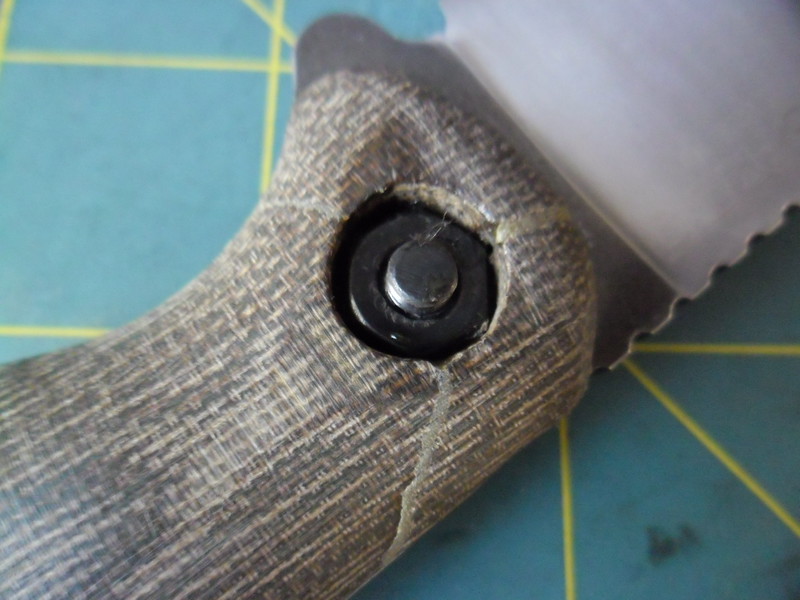

Ok, so I've made a few scales already so I'm not a scale noob in anyway but THIS?
002 by CamH_16, on Flickr
Yeah sure its fine no problem here but on the other side...
001 by CamH_16, on Flickr
Hahaha this has gotta be the biggest screw up I've ever made! I didnt know you could crack micarta by tightening the screws to much...
Note: This set of scales are made by ME and NOT Ka-Bar, I dont want people thinking that the factory scales are trash and as for me, this is the first time I've used removable screws on a handle and I think I might have drilled the holes a little too deep making the micarta kinda weak. Lets hope this doesent happen when I do my BK-7 ;).

Looks like the splits occured at the apex, or corners of the hex head, Hole too snug maybe ?
Yeah, I didnt want to go through all the trouble of making those dumb hex holes so I bought a drillbit that fit the screws very snugly. The scales arent even removable anyway, I epoxied them on and I chose the bolts over pins for aesthetics only. As I said eirlier though, the holes are very deep and the micarta was probably very weak because of that.

Looks like the epoxy filled it in just fine. I'd say that's some great work on those handles.
When I made some laminate wood handles, I just used a step drill and left the hex holes round. For the average joe, I think that's a decent way to go.
