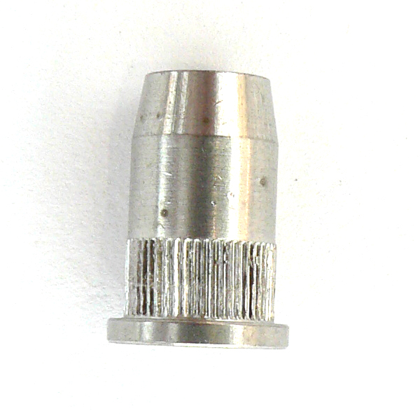

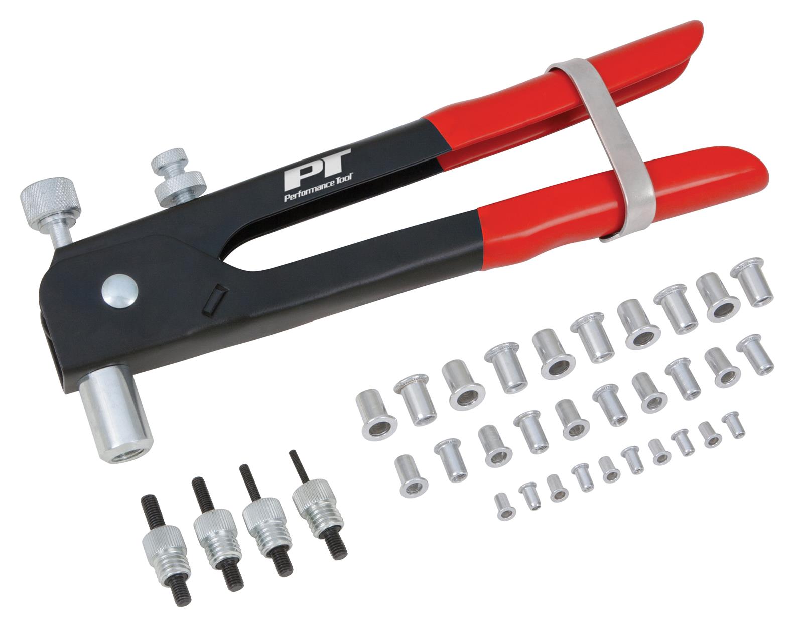

I know this is an older thread but in the interest of continued and archival improvements or suggestions I offer the following:
Instead of using the "Low Profile Nuts" as suggested to keep clearance with the sliding structural pivot arms. I suggest using nut inserts.
These are also handy throughout the project , especially the blade clamp. Its just saves on fumbling with nuts and wrenches when making adjustments or disassembly for storage.
The tool and a starter assortment of nut inserts can be found on Amazon or Ebay. Very very handy for all manner of little jobs.
