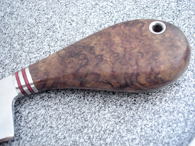

I picked up a beautiful set of honduran rosewood burl scales. I've been googling for a while and can't find whether or not they should be stabilized. 1 site says rosewood absorbs a lot of moisture, another says it's dense and oily. I've been waiting ages for these to come in and I'm chomping at the bit to get started with them :)

Rosewood is a waxy wood, and while it can be stabilized, It's
not recommended because...a) very little bennefit, .....and
b) the wax can continue to weep from the wood for some time
after.

I got ordered some stabilized Honduran Rosewood Burl scales from galleryhardwoods. For me it's better to be stabilized I guess as it is not as dense as normal rosewood, it is more light and has weaker structure. No wax wept from scales, I guess the stabilization quality is important. I made 2 knives out of that scales, they turned out great...
