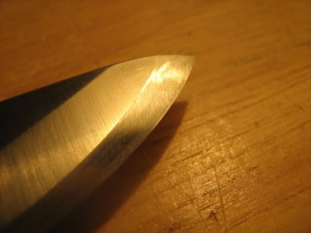

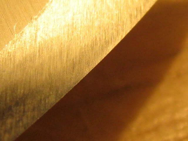

Hows your scratch pattern look? look very close under bright light and see if you have any small secondary bevels at the edge.
If your bevel is good it should look a little like this
from what i can see, the edge and scratch pattern fits the bill. It is real small though because I am working on a swiss army blade and I cant get a decent shot of it. The blade is sharper then its ever been yet I cant figure out why it wont shave... It does curls off hair, makes super fine curls of paper with nice clean cuts, push cutting is too easy.
