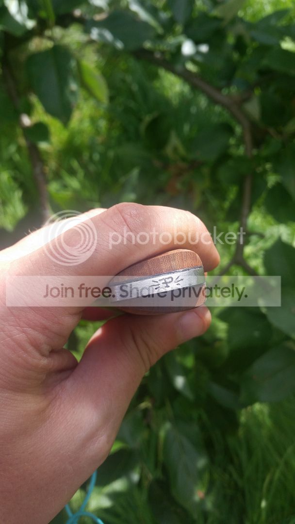

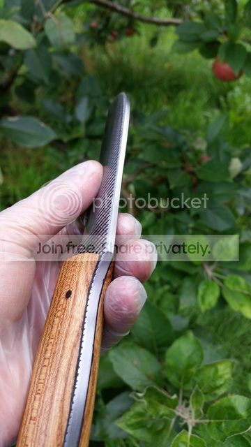

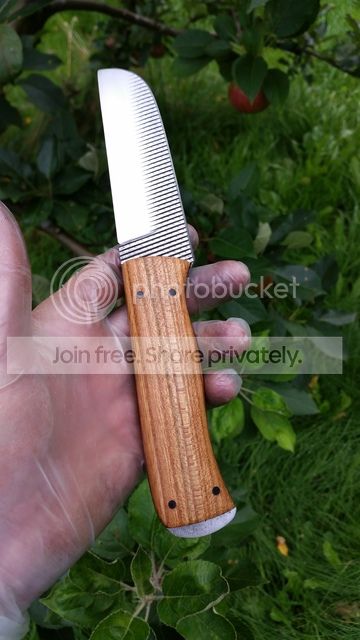

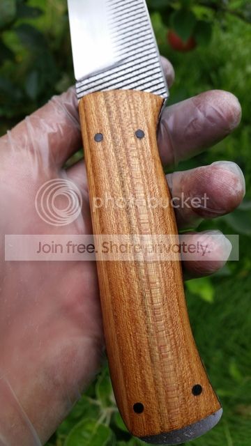

Cherry wood handle, carbon fiber pins. 120 grit finnish on blade and wood. One coat of olive oil. Bevel and crown on the spine done with a file. Custom for a farrier as payment in a trade.
Interesting. Did he specify that blade shape and size? All the hoof knives I have made or used were much shorter and narrower. Most had the end roll in a "U".

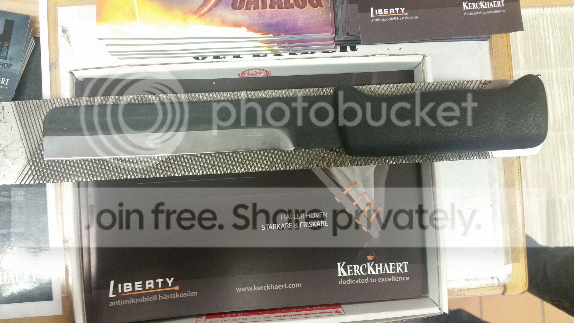

I know it od but maybe even fuggly. The farrier (second generation) was very specific, down to spine tempering and stock thickness. He had a finnish farrier knife as a reference and start of point in the design discussion (pic below). Both knifes are about twice the size of the normal knifes and have plenty room for the the non knife hand to act as a pivoting point or support. I guess some of our traditional work horses (huge) are to rare fore the big brand tool makers take notice.
OK, he wants a trimming knife. Your knife should do quite well for that task. Mostly I made knives to clean the frog and trim the bars. ( soft place in the middle of the hoof and the harder places on each side of the frog)
A toeing knife is driven with a hammer or mallet. Sorta like batonning. Rarely done in the US, but still quite common in Europe. Offer times with a helper holding the foot and the farrier facing the foot. Nice job!
Cool knife.

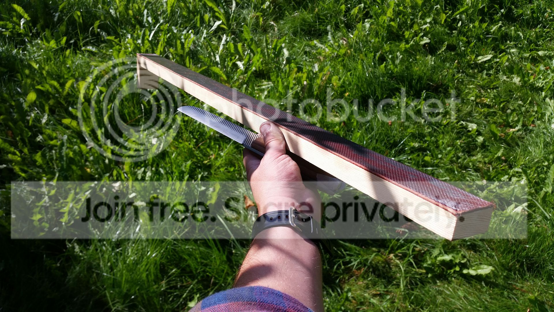

Putting the finnishing touthes on the blade. I finaly built a extremely over sized strop. Just a straigt piece of pine with an angel as an anchor. The leather is glued with regular wood glue.
The farrier was wery happy with the knife but immediately wanted a super sized version with an extended handel an extra inch at the ricasso.
