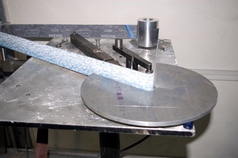

I built mine from a collection of parts laying around and parts I made. The stand is a import grinder stand with a 1/2 aluminum plate. The motor is off my Wilton square wheel after converting to a variable speed 220v. The tracking adjustment was something I had laying around and I turned the wheels on my lathe. The small wheel was off my Wilton.
I use this thing a LOT when building a slipjoint.
Ken
I was hoping a folder maker would show me a pic of their grinder! Thats why I want one.

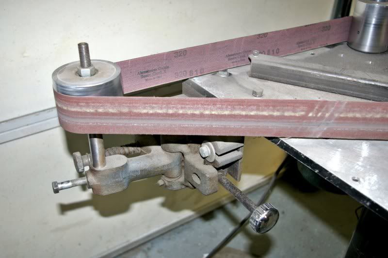

What do you use for tension? Have you got a couple more pics from different angles?
Thanks
Sean
The tracking assembly has the spring for tension. When I get out in the shop in the morning I will take a few more pictures and post them.
Ken

Here are few more pictures of my setup Sean, hope they help.
Ken
Sean,
My motor runs at 1725 rpm and the drive wheel is 3 inch dia. For the most part the belt speed is good but I would love to slow it down for doing the final belt finish on the insides of the backsprings. I take it down now to a used 320 belt and then end up hand sanding to a used 600, then to the buffer.
Ken
