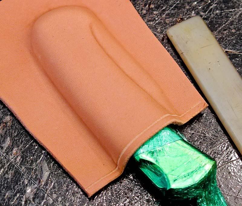

Then I take a groove tool to cut in my groove across the top, a few passes to make it deeper
Then I use the edge tool, from Weaver leather it's a #1 size
I wrap the knife in plastic wrap to prevent moisture from weeping from the leather
into the knife, see the green wrap around the knife here.
I hold the leather under running hot water until it feels pliable

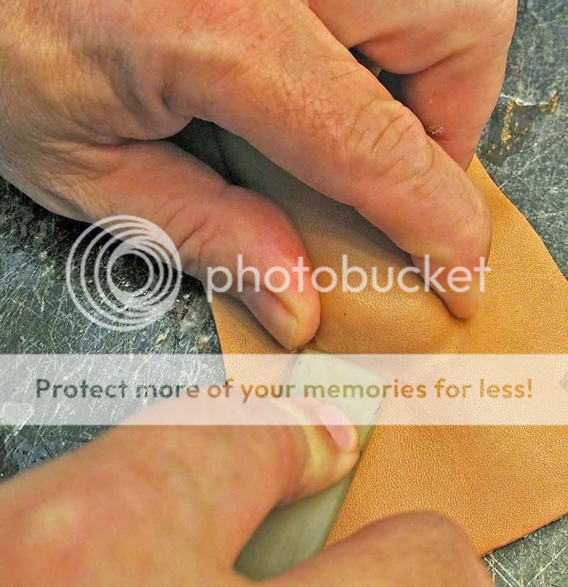

Using a bone folder, the square/rounded edge end, I start forming the leather
around the knife, first I'll press around with my fingers to get it started, a tip
on this is to keep those fingernails trimmed!
Work the bone folder along the outer edges of the knife
and while holding down what you've formed already, I press along the edge
of the handle and on top of the blade to form that 'shelf' of leather
More to follow, time for the sheath to dry a little, about 20 to 30 minutes between sessions
of forming. The leather wants to go back to it's original form, flat, so you have
to keep working it to make it stretch and this will aid in retention later on.

The sheath as you can just make out is kind of trying to pull back,
I continue to work around the sheath, especially near the end, important to press down
very hard to make it conform;
I take the pointier end of the bone folder and run that inside of the groove, it burnishes
it and gives it a more finished look, you do want to wait until it's partially dry to do this;
in this shot you can see where I've run the plastic in the groove and near the edge going down
it's still kind of flattened, so you can see the before and after in this shot

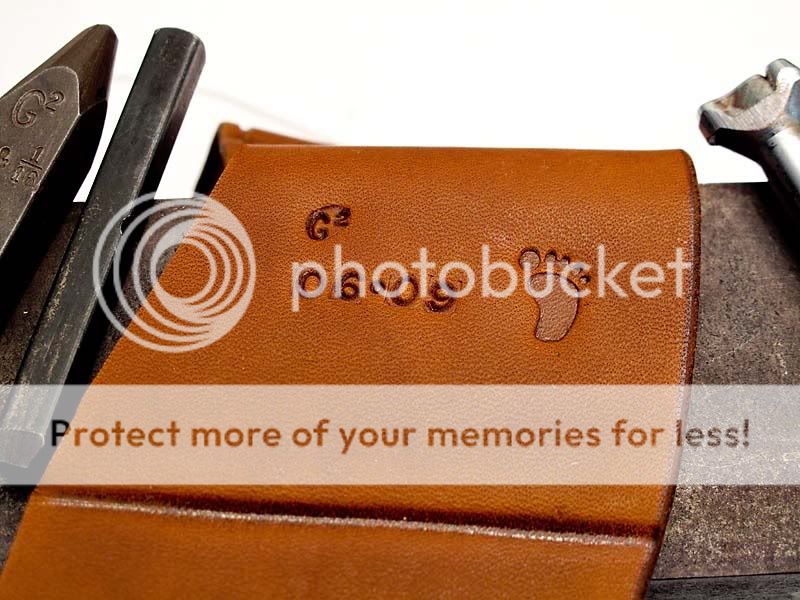

Ok heading into the next phase, with the top section now dry, I would emboss
but in this case the fellow didn't chose to have any embossing, which is fine
as the contours of the knife provide a nice subtle look all by itself;
Using Light brown Fiebings oil dye, leather is funny how it dyes, not haha funny
but in a way that makes you tilt your head, kinda like how a dog sometimes
looks at you when you do something silly...
Basically it has a mind of it's own, or actually the leather is more likely the culprit.
On the edging where I was pressing down hard, it will take the dye less, since
it's compressed, so you will see highlights and dark areas, the best thing I can
tell you about dyeing, is patience, dye and wait...

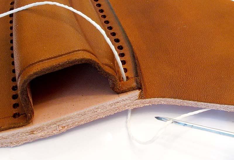

Ok a few more for tonight, sewing it up tomorrow;
One tip about the top section assembly, I DO NOT run the edger down the back side
after I sand the edges even, what I want to have is as flush a fit to the next layer as I can
SO, I take the bone folder and fluff the scraggly edges from the sanding along the bottom
out to the side as much as possible and then CAREFULLY, always carefully, slice that ragged
edge of leather off;
This fellow wants to have the sheath ride at a little tilt or angle while on his belt, so the
next layer has a curve that reaches out past the entrance, this way when you fold it down
it will provide the necessary tilt you need. I set the top section onto that and mark it's place
with a pencil and then dye just over the edge and off to the end of what will become the belt loop
close to the line I will take a knife to rough the leather up as near to the pencil line as possible,
without going over it of course, the sand paper isn't as fine a tool for this operation;
Glue the two sides and wait for them to become tacky
Carefully, there's that word again, set the top section down along that pencil line
rubbing along the top and inside with the bone folder to press it down tight to the bottom
piece of leather
I use a small screw driver that I ground down into an awl shape to put the holes through
this new layer of leather, necessary before I hand sew the sheath up
and tomorrow we'll be sewing it up.

I use an Awl-n-Awl, which has a handle, with a needle, I make the thread in this case
To be about 6 feet long, three feet on either side of the sheath.
Need to start by making a hole to slip the thread through the sheath so you have equal amounts
On both sides, the Awl-n-Awl comes with a little spool that fits in the area beneath the needle
Throw that away, I’ve never had much use for that, ever…
The needle has a smooth side and a slotted side, shown here;
The thread wants to be off of the smooth side when you put the thread through the sheath
Push the needle through the hole, then pull back a little to make a loop
Slip the top side end of the thread through that loop, making sure that the loop is on the smooth side of the needle
Pull tight and pull the thread back down through the sheath
You can see the way it hooks together here
Pull the thread/knot back into the leather until you feel that it’s about mid way through

Then I emboss my G2 stamp, the Month and Year and a Right Foot print, the foot print is
just something I have done for a while now, it means when ever you put on your sheath,
always go out on your ‘Right Foot’ in what ever you do, quirky maybe, but, that’s me in a leather nut shell.
Once glued down, I rub it with the bone folder to make a good and tight bond
