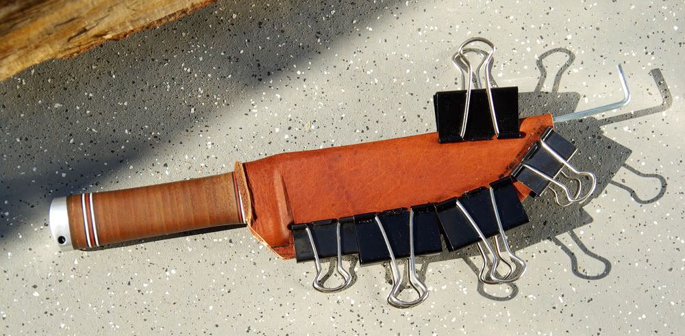

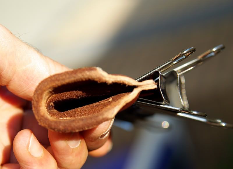

Even leather can be made let the blade snap into place.
Here's a freshly dried wetformed liner that does excactly that.
It's made from Finnish rawhide. They call it Lappleather.
It won't crack and will keep it's shape. Inserting the blade will only part the 2 scales of the cup a couple of mm's each, and won't stress the leather to a point where it can crack.

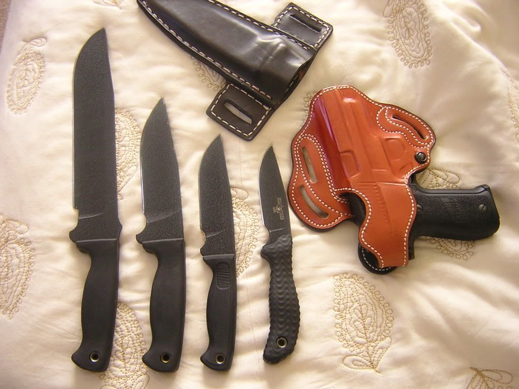

I have one of Dwayne's Leather sheaths for my Busse DABA, and the knife clicks in as secure as any kydex. I can and have carried it inverted.
I can put my S6 in the sheath in the top of this pic, hold the sheath by the tip, and whip the entire package as hard as I can, in an attempt to displace the knife, and it won't budge.
Leather can be made into a very secure sheath.
