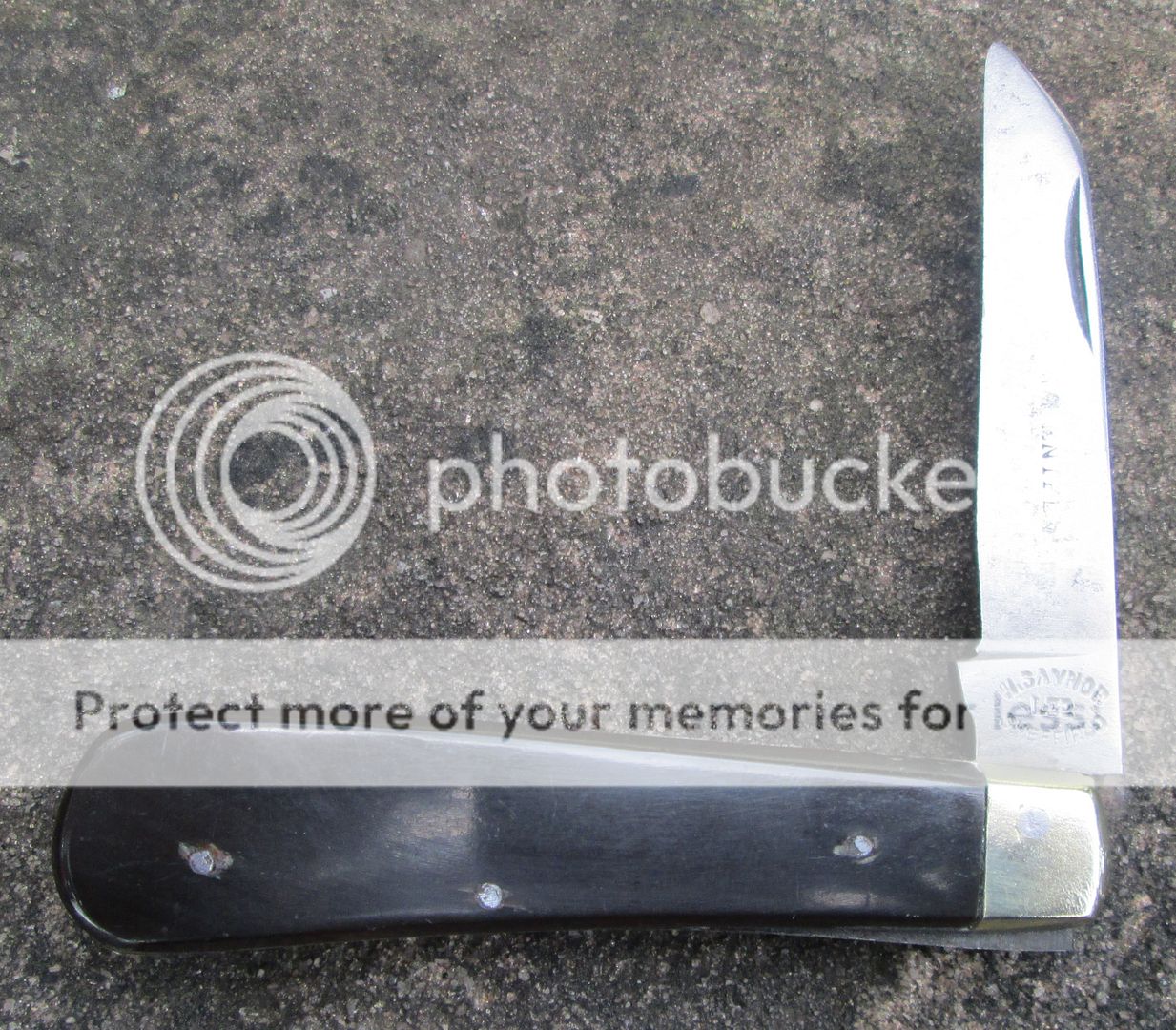

Jack do you think Blakes is real horn or hornite:o (syntho horn)?
"Hornite"! :D You should TM that Meako :thumbup: Hard to say. It reminds me of this IXL I picked up recently, which I think, upon reflection, is also probably synthetic.
I picked up 3 of these Saynor Lambsfoot knives a couple of years back, sent Charlie and Duncan one each, but I think that what I took for horn was actually synthetic (credit for this should go to Duncan).

To tell for sure, poke the handle with a red hot pin (in the end where it will barely show).
You must create a quick puff of smoke! Burning plastic is usually distinct in odor!
Horn smells like singed hair!

It does look like a synthetic I have owned.
Right! It has rather regular stripes which likely mean synthetic. However, it's still a very attractive and worthwhile knife.:thumbup:
Another Horn Test that's not to be recommended actually, is expose it to a very dry atmosphere (unlikely in England!:D ) if it starts warping and contracting, it's Bovine or Ovine, my Wright Lambfoot is not appreciating the under 20% humidity of indoors here....:(
You could put the edge on a buffing wheel, again the smell will tell you or if you're unlucky it could be Cell in which case it might ignite in flames!:cool::eek::eek::D
I can attest to the dryness theory Will.
One of the scales on my Ablett began to lift and I was fearin for it so I supaglued it back .It's been right ever since
I plan to do the heated pin thing at some point today. I have an old straight razor which is almost certainly horn (but, of course, very difficult to tell) which should give me an idea of smell one way or the other. Also, I can practice how to do this on something I'm not too bothered about. I'll let you know how I get on, should be interesting. Thanks to everyone for their interest. :)
Right! I've done the hot pin test on my knife and the results are conclusive. I tried the hot pin test on the handle of my straight razor and there was a distinct smell of burning hair; so yes, horn. I did the same to my newly acquired folder which released an equally distinct smell, but this time of plastic. :eek: The scales are without doubt synthetic. :o
So yes slightly disappointed I suppose, but on the other hand not really. It's provoked some discussion and I've learnt something, which is great. The use of plastic is, after all, very much a part of traditional knife history and an interesting sub-genre in itself. It's also relevant to say that that the early use of plastic/celluloid etc. in the early days was not just as a result of economic, or even practical purposes, but also because of the possibilities it offered aesthetically I.E. it also made knives look good, as this one, for me, certainly does. So would I buy the same knife again, for the same price, knowing it was plastic? yes I certainly would. Its a great old folder with a history and life of its own and that's what interests me.:)
