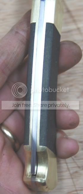

Here is a Buck 110 with horsemat inlay that I did. A Buckster on the Buck forum calls it the Horse Bucky. I did buff out the bolsters later
