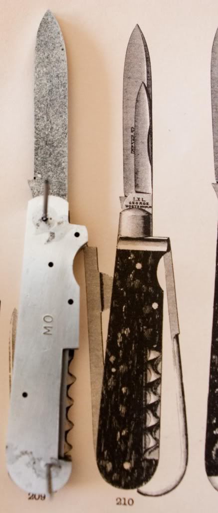

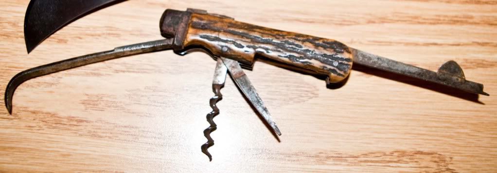

Ed,
Here is a picture of the Geo. Wostenholm that I used as my pattern. The spear and pen were broke off when I received the knife. Also shown is a picture of the reprint catalog that shows the 210 pattern.

Truly impressive. All the more so when you see what you were working off of. Brilliant.
