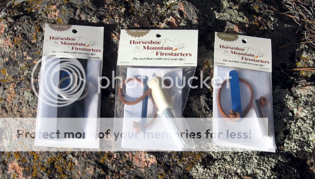

Based in the mountains of central Utah, family-owned Horseshoe Mountain Firestarters began in 1997 by making magnesium firestarters in their garage as gifts to local Boy Scouts. Eventually word got out about their handy little devices and demand grew, leading local stores and eventually Sportsman's Warehouse to start carrying their line of firestarters. For the review, I tested out three of their models:
(From left to right) 1) Keyring Model 2) Camper 3) Backpacker

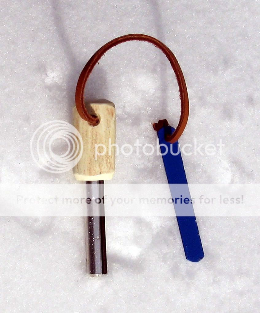

Though all three were tested and used to make fire, I wanted to focus on the Keyring model for the review. I've already had extensive experience with the Camper model which I've owned one for almost 2 years, and the Backpacker is just a smaller version of the Keyring model along with a smaller flint. The Keyring model also has the largest flint and is a great size for throwing in your pocket for emergencies.

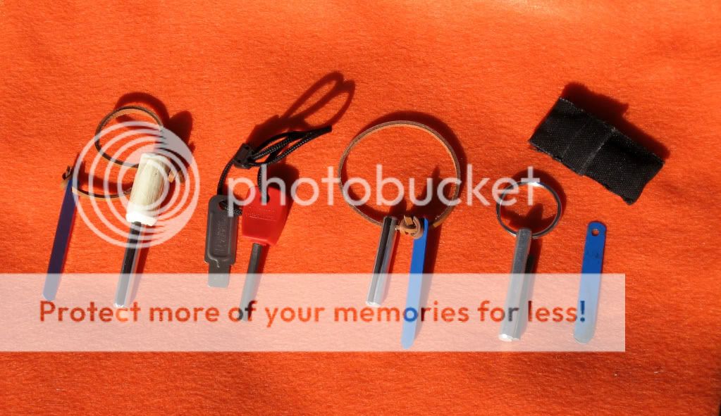

Here's a size comparison of the three models next to a Light My Fire Scout model firesteel:

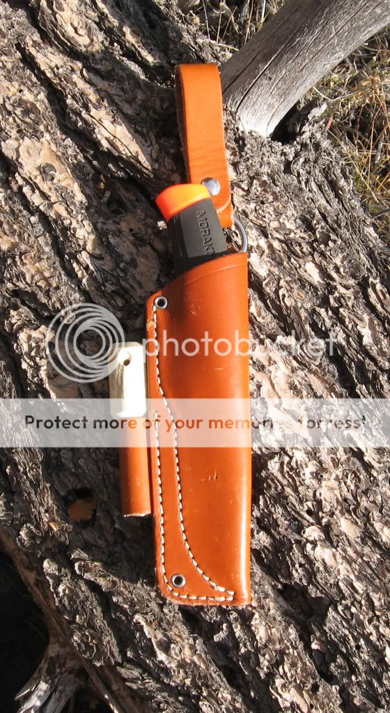

The Camper model will generally fit into Army-sized firesteel loops as shown on my JRE bushcraft sheath/Mora Companion knife (the backside of the Companion blade strikes the flint on these really well so I don't need the supplied hacksaw blade):

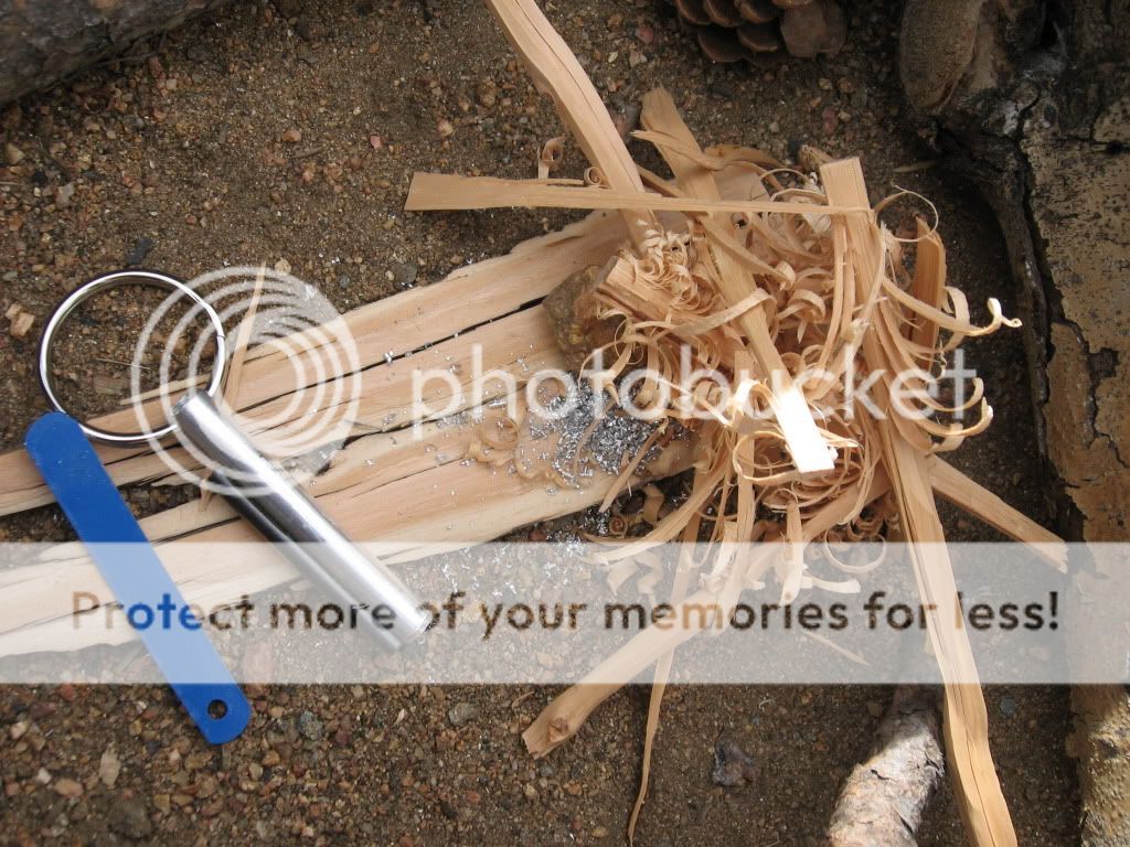

For the test, I split a dead Douglas Fir branch into kindling and created feather sticks with it along with three fire boards to scrape the magnesium onto. These pieces were all split with a branch as a wooden baton and a small knife, so this can be done fairly easy.

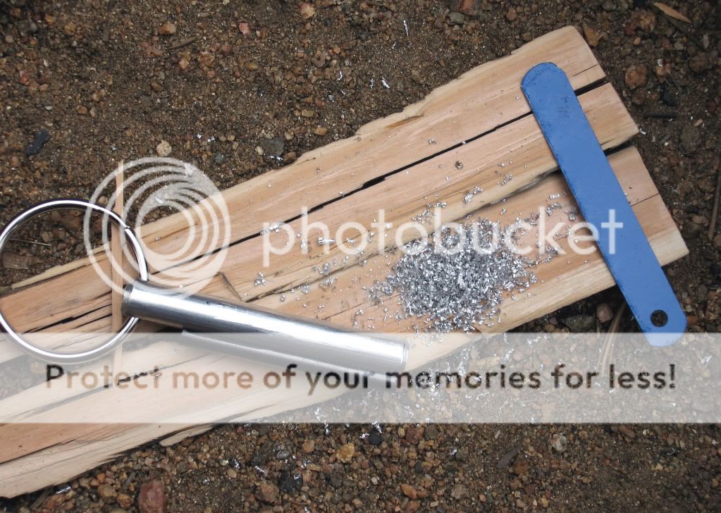

A pile of shavings slightly bigger than a quarter was easily scraped off with the supplied hacksaw blade. If you ever use a magnesium starter, always make sure to have your pile no less than quarter-sized or else the flame won't burn long enough or get big enough to get your fire started.

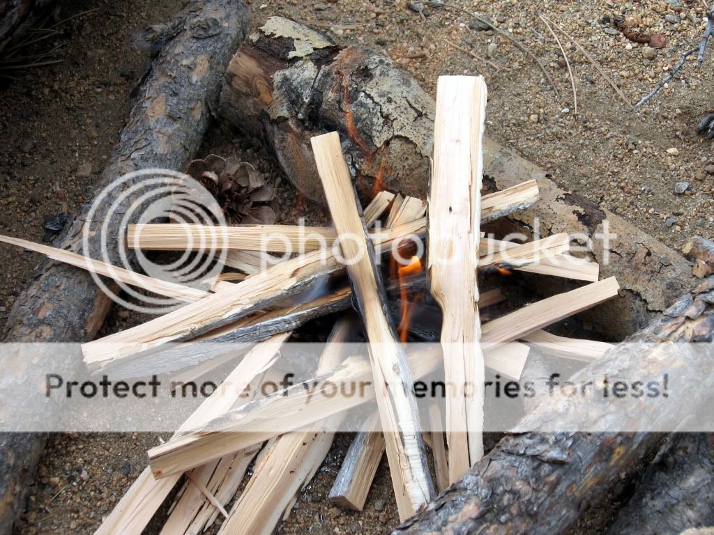

A small rock was then placed on the fire boards to elevate the feather sticks above the shavings and then the feather sticks were piled as close to the magnesium as possible:

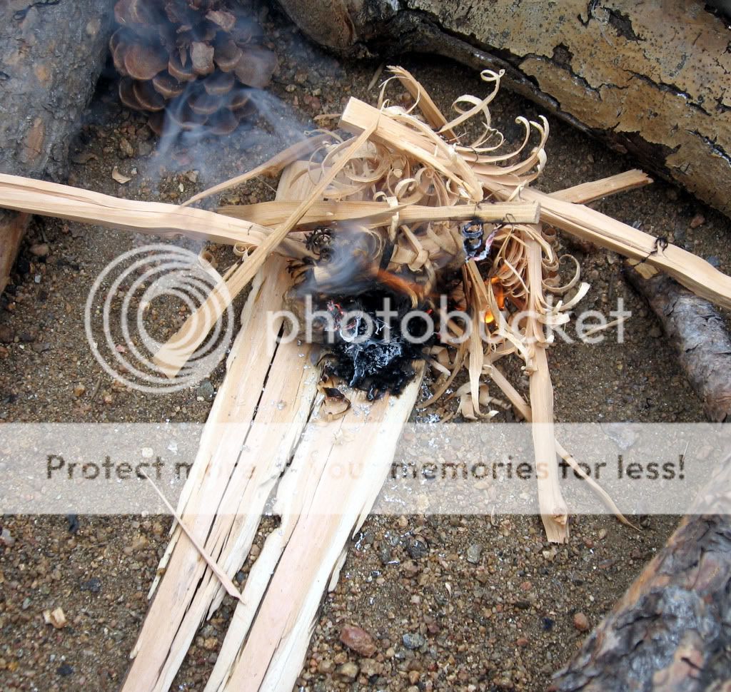

Sorry, no action shot as I was striking the flint (my body was completely blocking this area from camera view!). Here's the magnesium a few seconds after ignition:
Success:
