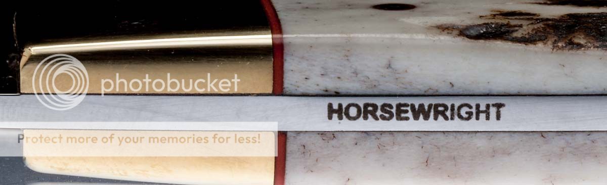

Dave uses AEB-L steel heat treated to around 60 and feels that way when I sharpened her up, ground down thin to about a .015" at the edge bevel she cuts quite well ! Also to note that there isn't any annoying notch before the edge starts, Dave made it angled up but also that small section is sharpened as well, so any material that falls in there will start being cut right away, nice touch.
I love a knife that has a bolster, in this day and age a lot of makers are getting away from that practice, maybe customer's demand? dunno, but it adds something to the knife I think when there is a real metal bolster on there, that goes for folders too, but then, I'm old fashioned. This has solid brass bolsters with decorative pins and red liner that separates the Elk horn scales, which also have decorative pins and a lanyard hole. Another feature that some add, others don't, those that know me, know that I really like a lanyard on a knife, several reasons, one is to help draw the knife from the sheath or pocket. On this one I made a small BobTail fob, the knife goes in quite a ways into the sheath that Dave made, and yes he is very adept at leather work, for those that haven't had the chance to view any of his handywork, I'd recommend checking him out in our leather section area of BladeForums.

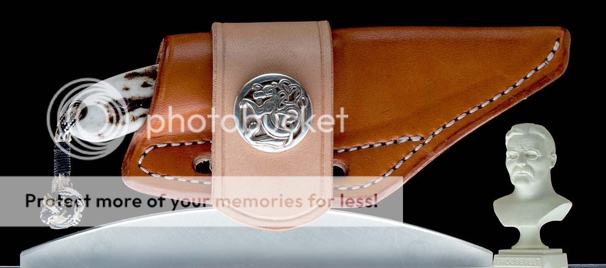

Now, if I were a cowboy, Slim would not be my nick name :) so a cross draw right now wasn't working for me, so in the photo below you will see an adapter I made with a neat concho that doubles as the top snap for the adapter, now I can wear the knife horizontally and is handier, for me at least. Dave has a nice detent when the knife/bolster is fully seated into the sheath so there is little fear that the knife would ever fall out on it's own.

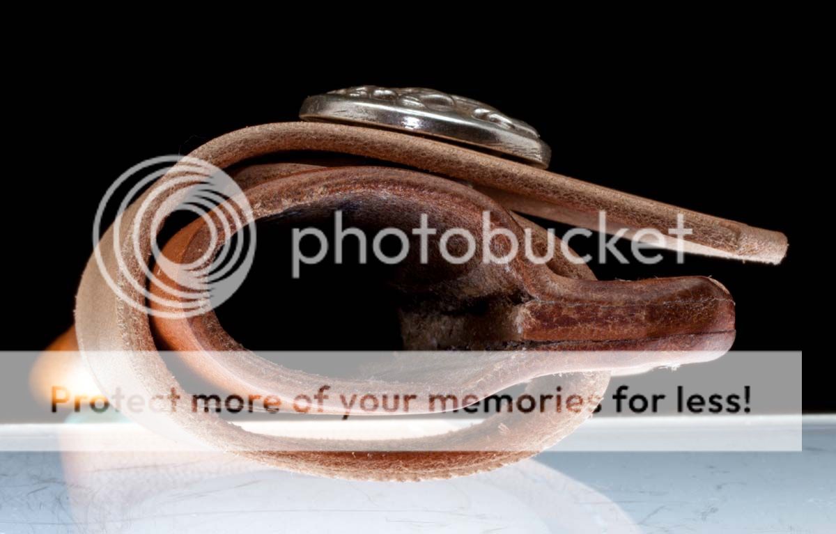

Here you can see how the adapter loops around and is held in place by passing through the slot and snapping on the front, with just enough below the sheath to get a purchase, you can unsnap and remove from your belt if you need to do so quickly.

That concho looks like a Celtic dragon motif? Very nice.

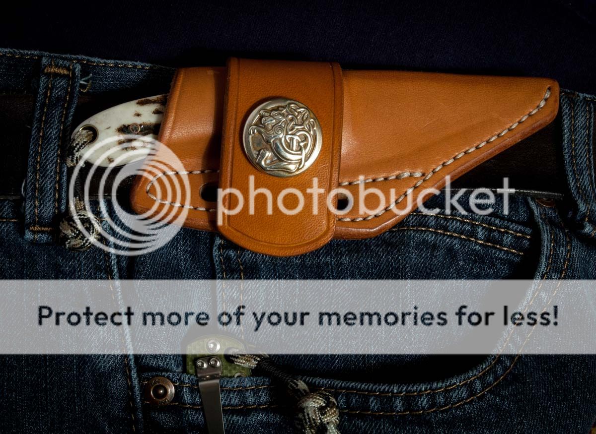

Thanks guys, she's a beaut and quite capable knife, here's a shot taken on the belt with the adapter dyed saddle tan, close to what Dave has on his sheath;

And yes, that's a Celtic dragon concho, pretty neat, had to grind down the head of the screw to allow the snaps to work together, that was a fun thing to do ;)

Thanks for chiming in Dave and yes, not sure why it didn't darken up, it's Wickett & Craig leather, good stuff ;) but in any case, she's pretty close match now and the folks at work liked how well it rides even with the belt like it does.
