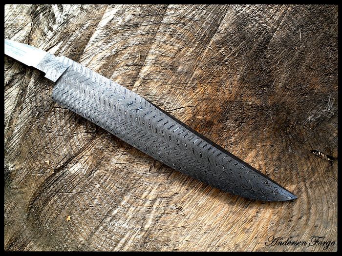

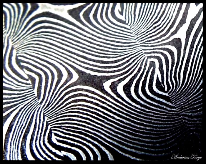

The process for hot bluing a damascus blade: 15 min in metal cleaner, rinse in cold water, 20 to 30 minutes in bluing salts, depending on desired color. Longer for black, shorter for blue. Salts are kept at 292 FH. while bluing is taking place. Rinse in cold water and inspect for flaws. Place in boiling hot water for 15 min, move from hot water to water displacing oil in one motion, it wants to go into the oil when the piece is at 200+. Leave in oil for several hours. Sand the surface with 2000 grit paper on a block to bring out the highlights or leave totally black, both are nice.

The top blade is hot blued thirty minutes without the surface being sanded. The second blade is hot blued for thirty minutes and the surface sanded using 2000 grit sand paper.

There ya go. Mr fred knows what he's talking about and sounds like he's done it alot more recently than I have.
