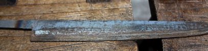

You can see the hamon even now coming out. I know the picture is not that good. But you can also see the layers of the tamahagane showing here.
I am going to ruff it out today.
If things go well i will start to have it polished tomorrow.
Differently heat treated, at the spine near the handle it is 4.0mm but will taper off to 2.5mm near the tip if i do it rite.
Notice the handle is still soft. It was protected by the extended handle bolted on to keep the HOT fire away from the hands.

LOL! What?! Nice knife, looking forward to seeing it finished... :thumbup:
