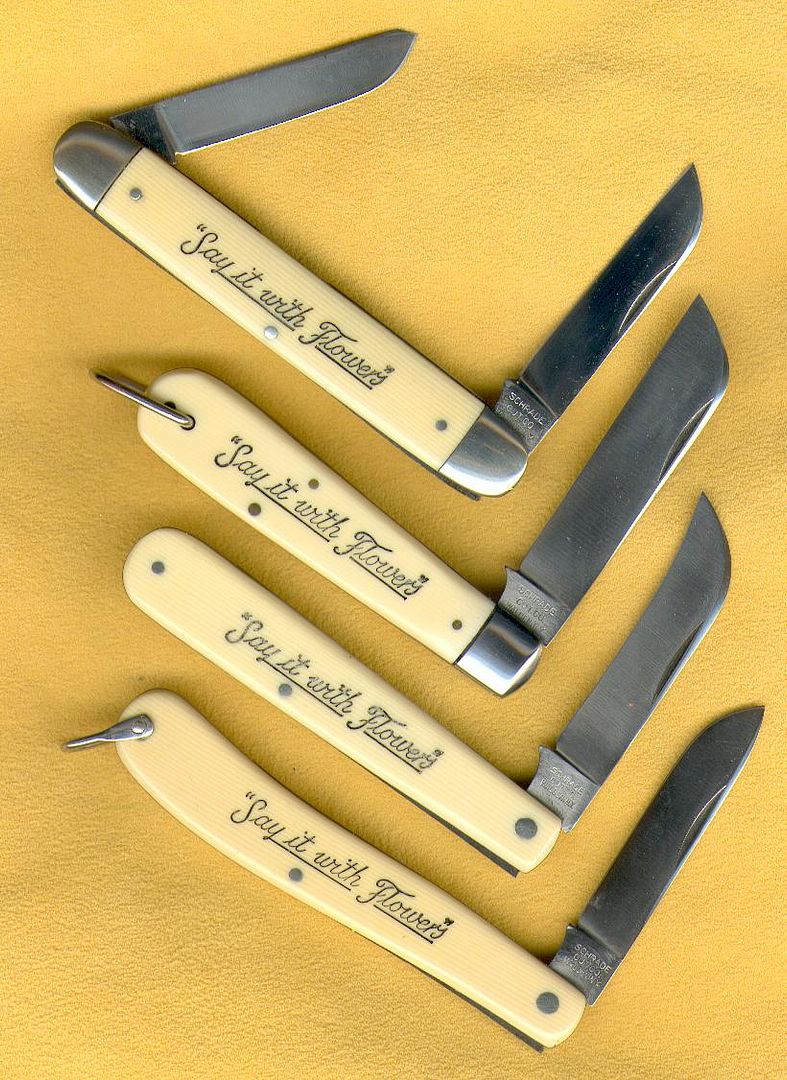

Here are some products of the "Say It With Flowers" hot stamp!

$1.45!!!:eek:
It'd be nice to see one in the flesh!!
