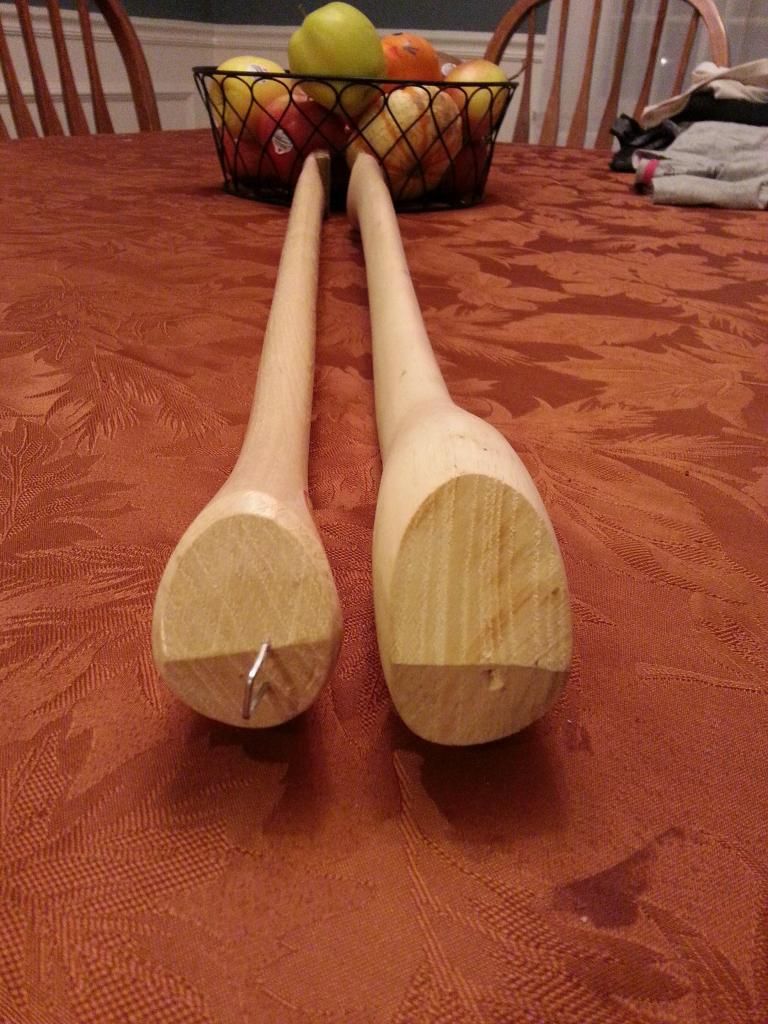

I simply cannot understand the shape of the swell on those handles, it is completely unusable and wastes the last 2" of the handle.
I think they go too thin with their octagoning. The crick they put in the haft at the turn to the swell is a little much. The widening into the swell should be more abrupt, not so gradual.

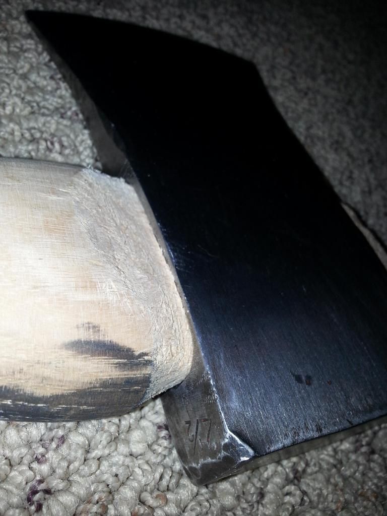

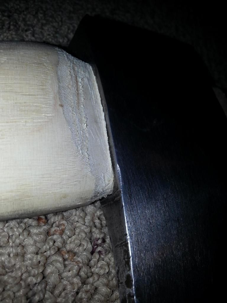

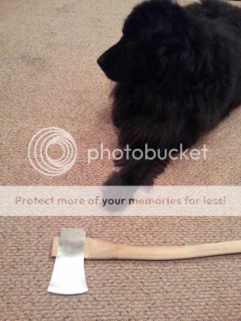

Things are getting worse. What looked good at first doesn't look good at all after lining up an axe head on the boy's handle. Once the head is lines up you can see an obvious tilt that has the blade way off center from the handle. In reality, it looks much worse in person than in the pics. The head is not fully seated, just starting to seat up high. This is a AA hand picked handle, I'm very discouraged.
That really looks like the head is off not the handle.... take more wood off the side it leans towards while fitting it. That is operator error not the handle
I know that its tough to see when you don't have the handle in person, but its not me. I just lined up the head, have not seated it yet. The eye and the wood are symmetrical and a close match. When they are aligned properly, the head aims the wrong way. Its obvious in person. I've sent pics to House Handle, will see what they suggest. I'm willing to work it, but worried that if I take off enough to straighten it, there won't be enough left for a snug fit. I'll keep things updated.
It's hard to pass judgement on a handle when the head isn't seated, especially one as far from it as that. It appears maybe half way through the eye? And the kerf looks closed to me - can't see much of it, but that would suggest to me that right now it's simply tight in whatever cockeyed position it might be in, and the slightest move could change everything about how it looks.
It may be surprising how little material you have to remove to straighten it up. It may also be worth taking a look to be sure the bit is actually straight on the head. I do know what you mean about pics making it look less severe than it is because I have also tried to capture really crooked heads and hangs and it never shows up the same as in person. With that said - it certainly looks crooked, no question. I am also detecting the crooked swell which is very common - if you picture the handle as an egg shape in cross section, it is not uncommon at all for the peak of the egg to be off to one side and a crooked handle can really be a visual problem more than a real problem ... if that makes any sense.
I've had the same problem with handles from house. Just rehanged a head last month that looked about the same; bit facing off at an angle. Definitely was not my rasping that was the cause of it.
If it's not off too much it's not a real problem, but with it off that much it's potentially very dangerous; feels like you're swinging the axe with enough angle to bite only to have the cheek glance off the log with a lot of force...
I'll work on it and also see what House Handle says and keep the thread updated for those that are interested. I just picked up a decent looking Link boy's handle on the way home and may do a side by side thread, and if I need help seating this stupid thing I'll ask advise from the experienced members in another thread as well. This thread I would be more comfortable keeping to it's original purpose, which is a report on my ordering experience and impressions on the product.

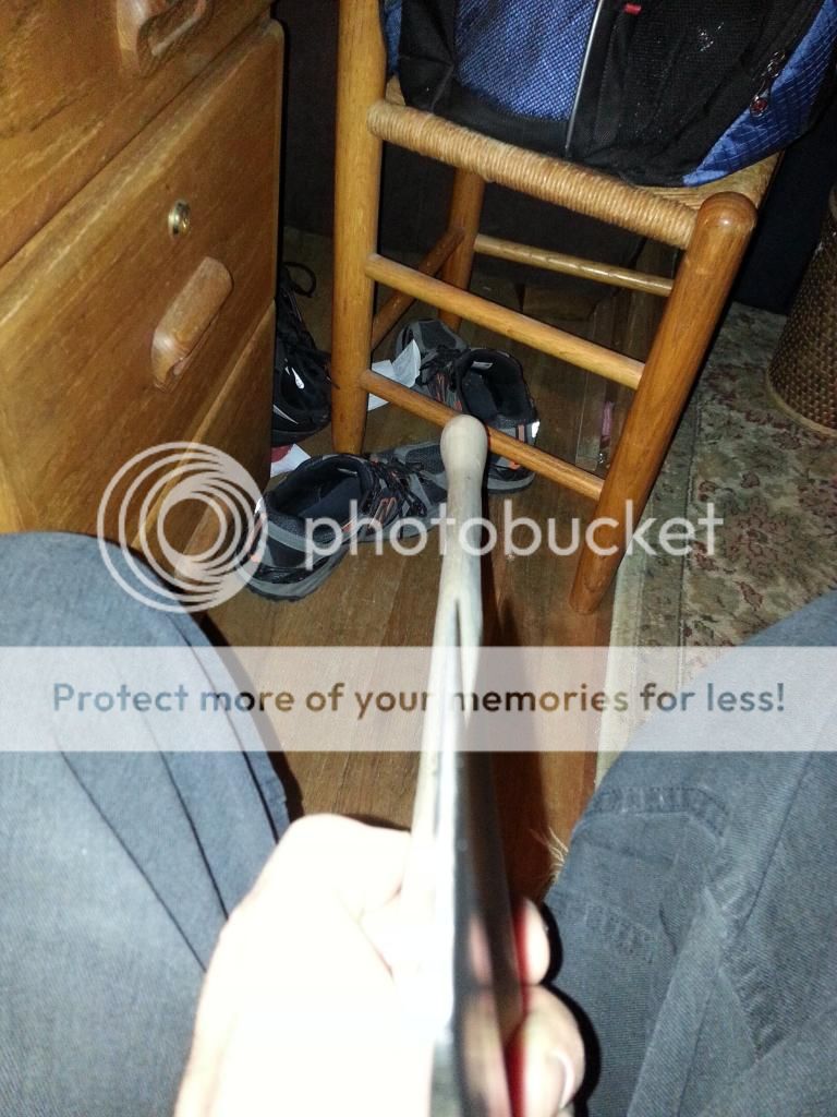

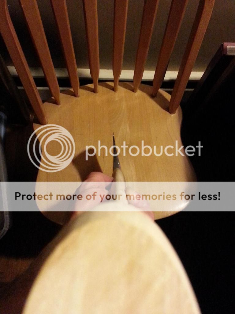

For quick comparison, here are the two from the same angle. I tried to sight straight down the handle, as that's where my hands will be and that is the functional center line. I don't want to go picture crazy, but I will post any specific angles or shots that people might be interested in.
House Handle
Link

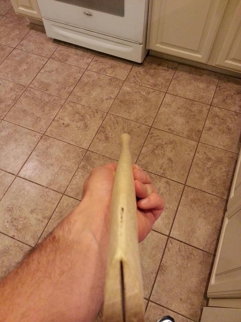

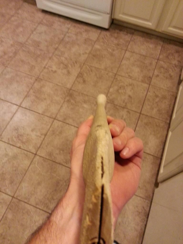

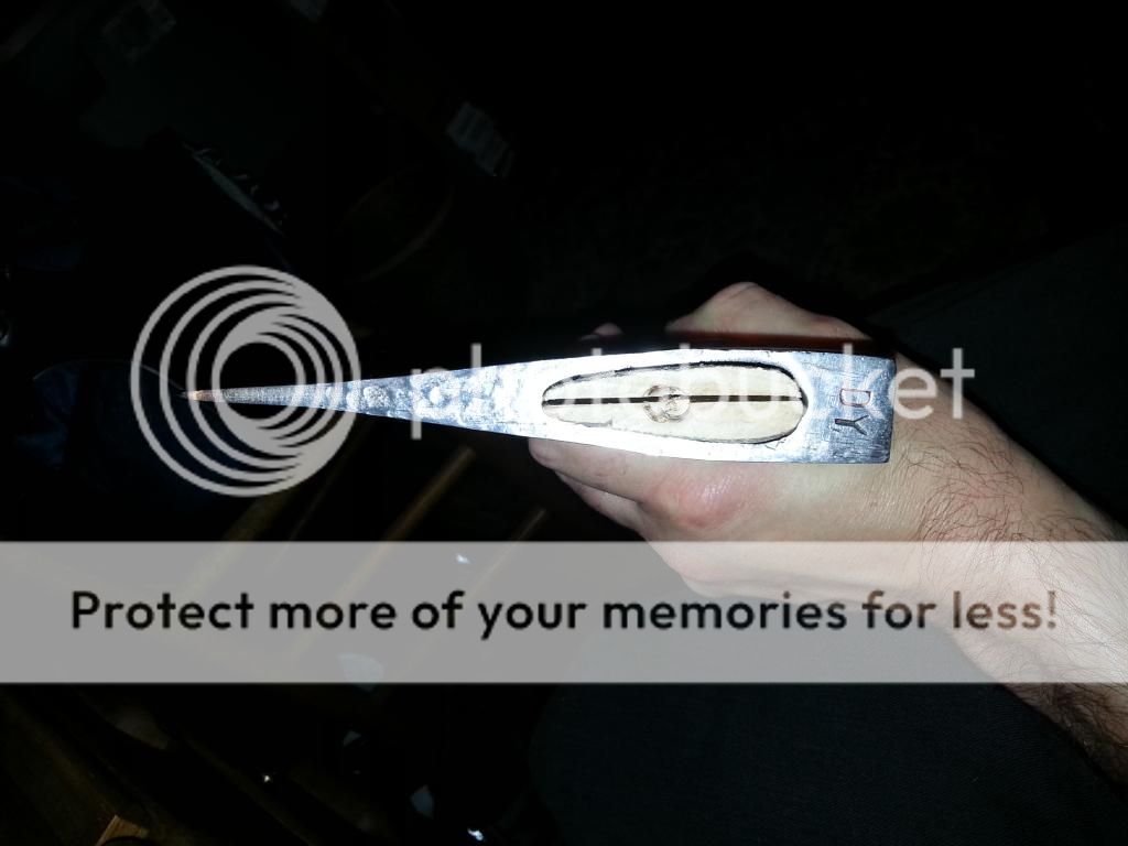

So I have it on, ready for the wedge. The black marks are from the rubber mallet and will be cleaned off. This is where my inexperience is playing games with me. From some angles it look not perfect but more than ok. Perfectly usable and a good job by a non expert. Hey, I wasn't into this stuff 6 months ago, but I'll get there. From other angles it looks like crap. I can't tell it it's just a bad handle, or all of my perception and visual cues are being thrown off by the asymmetrical bulges below the head and also on the swell. It could be that simply reshaping those will make it look great, or the head may still be tilted. I simply don;t have the experience yet to have a feel for it. I will say this, I am surprised by the amount of work that it takes to get a prime handle into shape. My feeling is that this will be a good user if not a show piece. If that is the end result I will be happy for the learning experience.
Seated. Natalie the Newfie says thank you in advance.
If I sight down the blade it looks off but close enough.

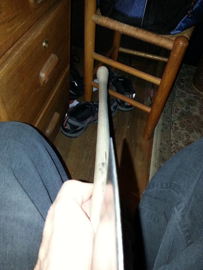

If I sight down the handle I don't like it.
Comments and opinions welcome. I have no ego here and want to learn if it's me and not the handle. Maybe I'm being to picky? Also, I/m hoping that this isn't just for me, I'm hoping that enough info comes out of this to help other re-hafting novices just getting into the hobbie.

Your 5th photo there doesn't look so bad, but your 6th photo worries me. You can compensate for a head being slightly off, but if it's as bad as the 6th pic shows you could get into some serious trouble using the axe. Swinging the axe you're going to have the tendency to hold the handle as though the bit were in line with it. Say you're bucking a log and you're swinging on the chip side (if you're right handed this is the left side of the cut), if your hands get tricked by the handle into thinking your coming down at about 45% the bit won't bite, and the cheek might bounce right off of the log. IF this happens your on a full swing the axe could bounce back and do you some serious damage.
If you aren't happy with it, just pull the head and rework the haft (you have plenty of wood to work with there), going slowly while fitting and refitting the head a few times. The scuffs from the head should tell you where some material may need to be removed. Or if you want to re-align the head, simply rasp away material from the haft in opposition to each side (i.e. front left, rear right) to get the head to "turn." You have a lot of material to play with, and a thicker wedge can always be used to compensate. Also, these handles will never be perfect...some variation is to be expected. Or, if the haft is really that twisted, just contact HH for a replacement. I would echo the above though...no one wants to use a mis-aligned axe. So if you know it's wrong, and you're anything like me, you won't use it and it will just sit there. I say re-work the handle as much as you can until you're happy with it, and if it's just a matter of a bad handle, send it back.
It's hard for me to tell from the pictures but I have recently had a similar experience. When you are removing material from the opposite side it should allow the head to move in that direction. I had to do that for one recently and it acted like it did not want to move no matter how much I shaved off one side until I stuck a wedge in it slightly. Kept thinking, "I am removing material and it's not moving in the direction I want it to". Nice newfie by the way. They are pleasant dogs.
