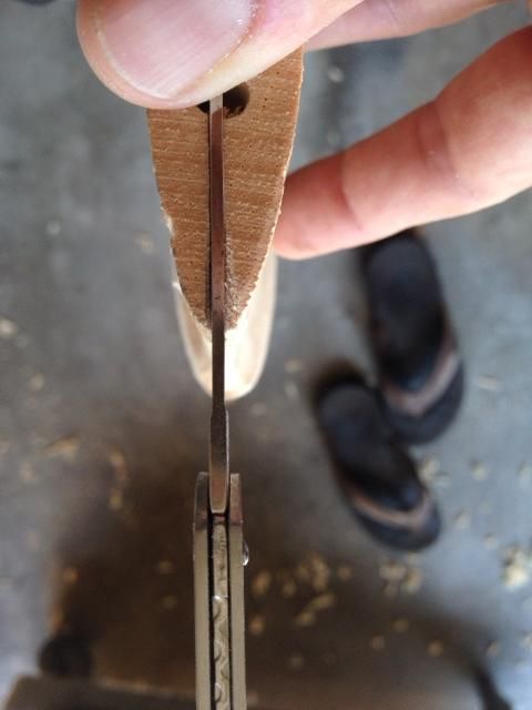

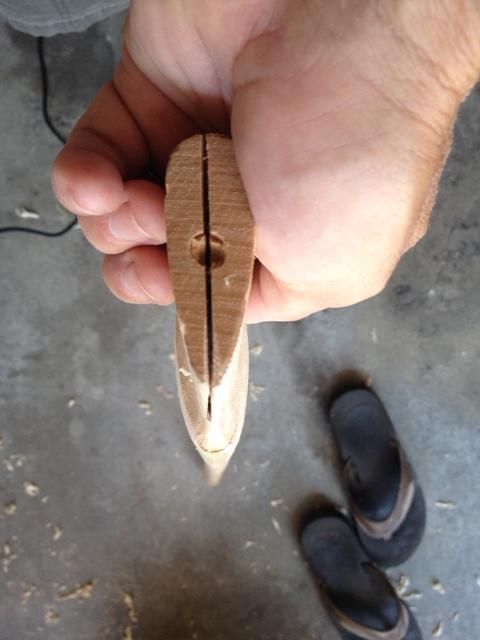

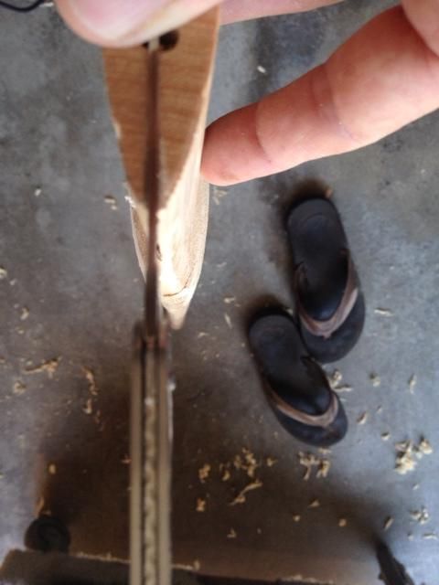

It seems all my other handles are centered. But I just received this 36" straight bit handle from House Handle and it seems really off center. I've been leveling out the ("cheeks"?) because it was really "bulging" more on one side (I think this is typical) but now that I look down the haft, it's off center. Head blade and haft will be WAY off on this one.
Is this typical of House Handle? Is this the first time I've noticed hafts are normally off center?
Edit: You can really see it in the first photo.
looks warped or crooked to me. crooked handles in todays handle market are a very common occurrence.
that said, i have sorted through MANY MANY handles that had the eye off to one side or the other instead of inline with the center line of the handle itself. those handles, unless very slight, do not get used by me.
the ones that are slightly off center can usually be corrected with a rasp when hanging the head.
another point, the kerf can be off center considerably, and not cause an issue with the final hang, as long as the actual eye is centered up right.
i have a local supplier that has a fair selection of House Handles, and i have never used a single on on any of my axes. i have not been pleased with the quality, shape, or grain orientations on any of them. the swell at the end is usually funky shaped IMO, and a bunch of material needs to be removed just below the head itself, if you want it to look like its hung up to the "shoulder" on the handle, and so that it clears when splitting. i keep clear of the house handles, i dont even stop to look through them anymore.

I think the kerf was sawn off-center. A common occurrence. I sometimes try to re-saw it straight and centered. It shouldn't matter after it is wedged as long as the axe goes on straight and is centered to the handle, not the wedge slot or kerf. In the old days many handles were sold without sawn kerfs and you had to saw your own. I wish they would still offer them that way.

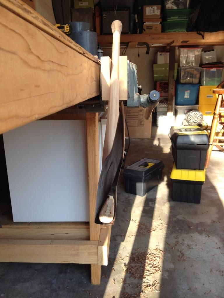

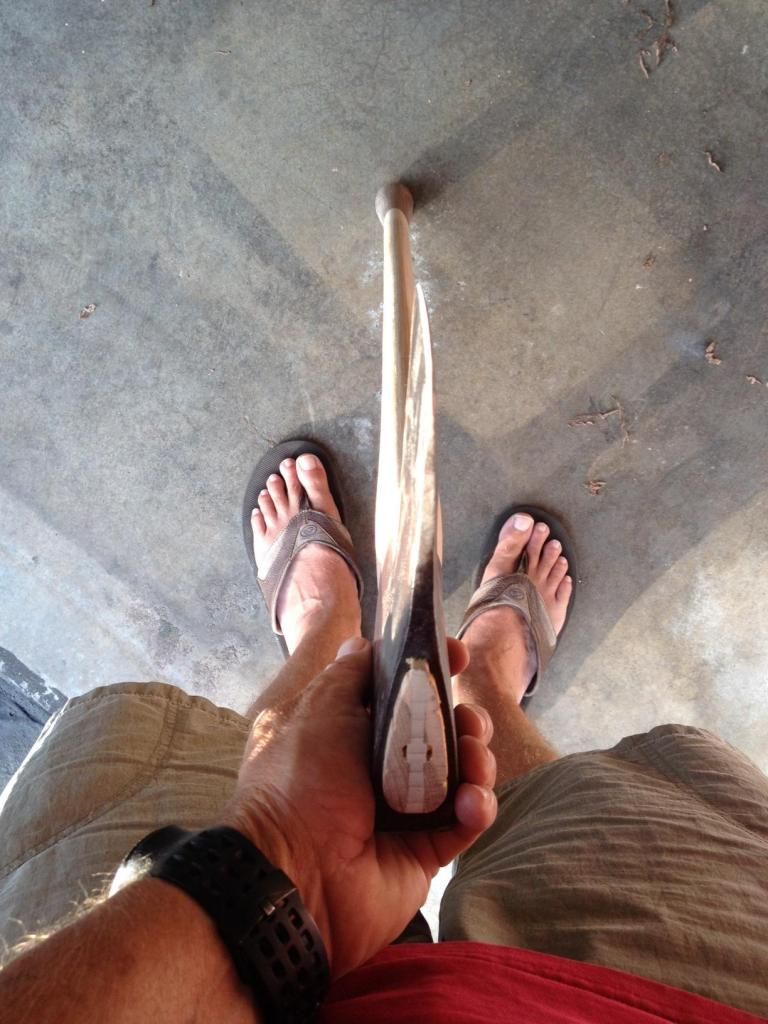

Ok. So I received the replacement handle. Hung it, and it seem a little "twisted" to me.
I checked all my other axes and these are the only two that I've issues with, the first one I posted in this thread and now this one.
Am I just a rookie, or does the handle have a twist?
Did I just hang it wrong?

It's not that you have to specify AA. You do, but what I'm trying to say is you will notice there are two grades for most (or all, I dunno) of their handles so you'll just add the AA to your cart. When you are at your shopping cart page it tells you that if you want one hand picked, or this or that, to write it in the order comments - it's kinda primitive as the internet goes, I know. You may fully understand all this, but it gets lost in translation for me on forums some times. I'm not sure grain orientation matters that much and your new handle looks fine as far as that is concerned, but it's tough to tell about the twist from the pics. If you ordered "FH" grade, you are just getting what you get. A local hardware store near me carries a bunch of HH sticks and I am sure they order FH grade - it's a grab bag and some are terrible, some are fine.
