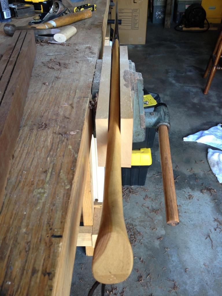

Here are a few photos of comparison.
House Handle 2nd replacement. Does this handle have a twist?
Is there such thing a quality control in these places?!

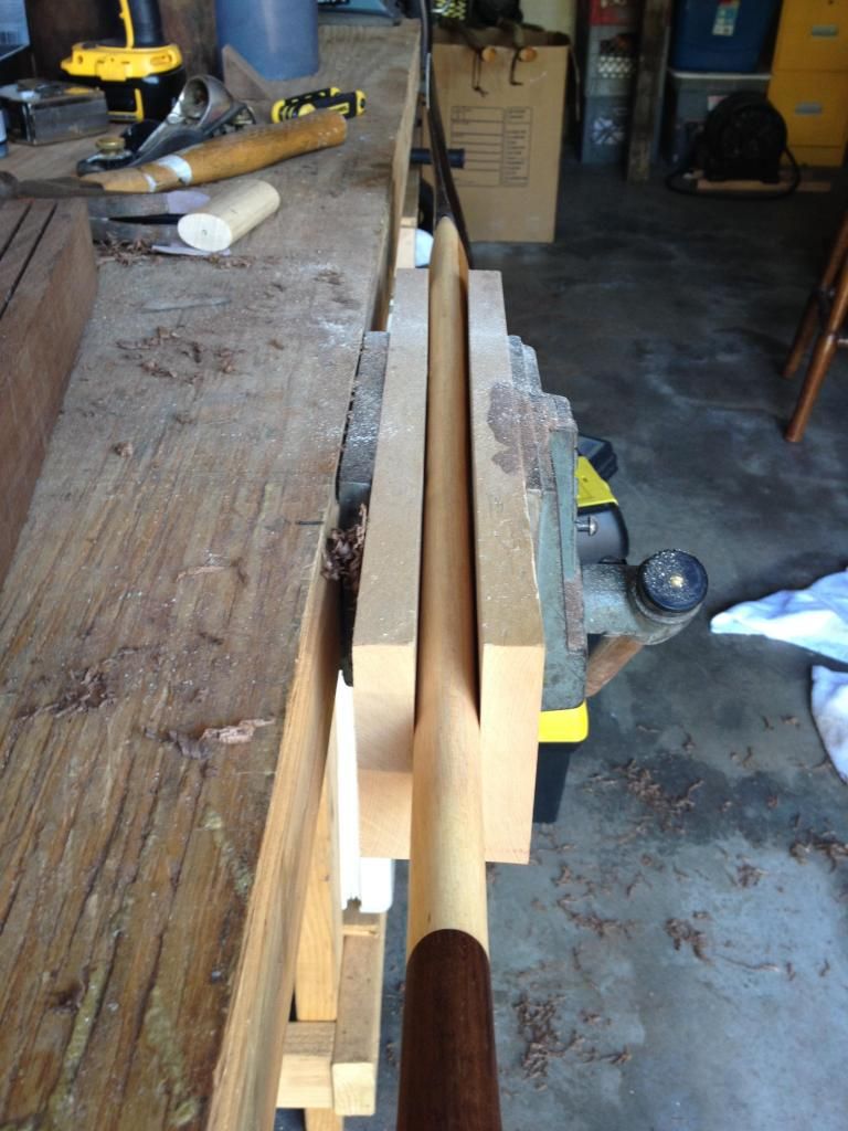

A couple that are straight. This may be a House Handle, not sure.

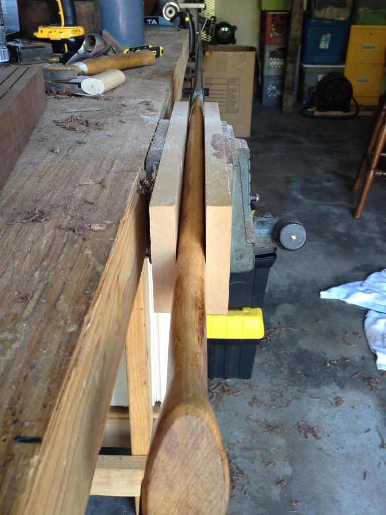

This one, I'm almost certain is a Link.
Well, that top one does seem to have a twist. Could it be fixed by pulling the head and re-profiling the eye portion of the handle?

To stay on topic, yeah that handle looks wrong to me based on that shot - sure seems like it's gonna want to glance to the right when you use it. It may not be twisted so much as shaped poorly I suppose. Looks like it takes a turn halfway down the handle and it also appears as though the grain runs naturally. If there was enough material you may be able to remove some in order to move the high point on the bottom half over in line with the bit.
Brett, no it seems there is little quality control these days when it comes to handle turners. ordering handles online just seems like a headache to me, and is exactly why i havent even attempted it... im pretty picky on handles. i cant say if your new handle is twisted or not. i trust that you have it mounted in the vise straight, so it appears it does twist. would need a shot looking down the bit toward the swell to be sure. the second handle looks like a Link to me, as the cut off on the fawn foot is almost never straight and the swell generally isnt either. another thing is that handles these days arent nearly flat enough on the sides. they should be much more oval shaped as opposed to nearly round like they are today in most cases.

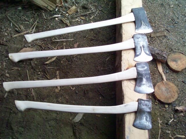

You don't need any power tools to make an axe handle to have "proper tools". I've been making them for years just using a hatchet, draw knife, spoke shave and block plane. Finished off with a piece of broken glass as a scraper. It helps to have a good system in terms of splitting out your blanks. Splitting is much faster than even sawing with a bandsaw, so cutting it close to the desired shape and dimensions with splitting really speeds up the process.
Making handles is nothing to resort to-- if you really want to seriously get into axes, I think it's just a matter of course.
Here's a picture of some of the more recent handles I've made.
