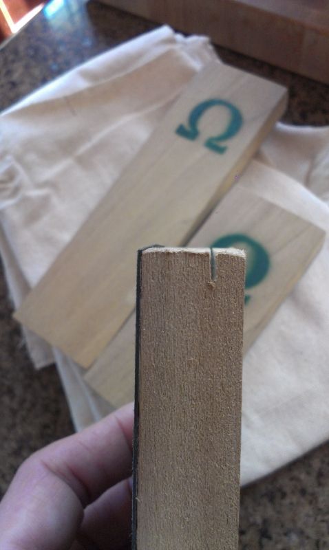

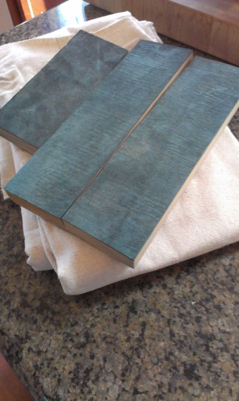

Different leather will obviously impact the finish.
On the ones I make I use extremely thin black chrome tanned leather, nap up. The stuff is almost as smooth as the grain side, but can hold compound if necessary.
Cut a slot in the top and you can put the end of a strip of 2.5k (or whatever) wet dry and fold it over the back.
I'm not currently making strops, but buy some good leather and it's easy to make your own.
