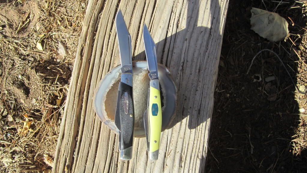

I have a 301 and 303 in yellow Delrin. Great, stocky, sturdy knives. Better at cutting than slicing due to the blade profiles.
301:
301 in hand:
301 and 303 size comparison:
