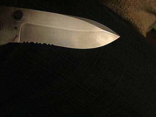

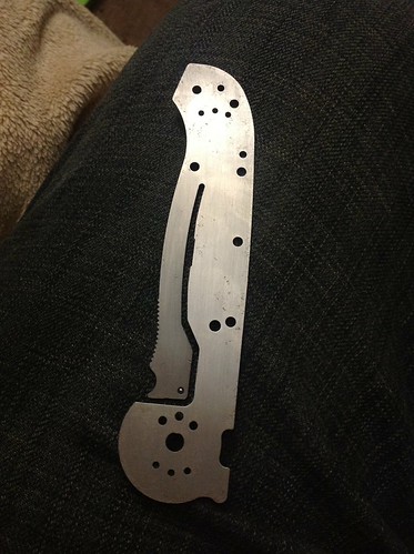

I just read through the rest of the responses, lots to consider. What I've done so far is to hit the blade and liner with some WD40 and then scrub 'em up with a heavy-duty and then medium grade of Scotch Brite pads. Most of the rust came off, although there appears to be some minor pitting here and there. Just for kicks, I went over the two pieces with 320 grit sandpaper, but I may have to drop the grit to try to get those pits out. (Beadblasting or sandblasting or any kind of blasting is impossible ATM.) Here's some pics to show progress/what I'm dealing with currently:
Anyone think 200 grit can handle this? I don't mind a lot of sanding, I just watch the NBA playoffs and listen to music while I do it. I think I want to mirror finish the liner, too. That would look really cool coming through the scales. Like I said, this is my first "project" knife, so I don't mind any extra work as long as I learn something.
Thanks!
Not too shabby. Just remember, to "remove" the pits, you actually have to remove all the steel on the entire surface, down to the bottom of the deepest pit. Personally, on a $60 knife I wouldn't bother. Just polish it up.
Yeah, I know. I thought about just going for the mirror finish now just to do it, and that's what I'll probably do. Will the pits continue to wear at the blade and liner now that I've cleaned them, like a cavity wears into a tooth regardless of what you've done? Or have I pretty much stopped the spread of rust at this point?

Yeah, I've started to realize this. The thumbstuds are definitely in there to stay, so complete flatness is not happening. I might just satin finish the blade and mirror polish the liner, so that way I'll at least have some experience going through the process. Plus it could look cool (I hope).

I say go for it on the liners, it's good practice, but in my experience, liners shine up with much less work than blades.
Knives do look cool when you mirror the liners.
