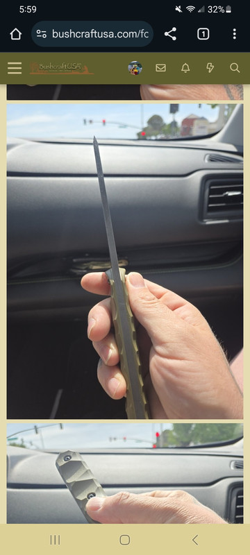

I'll give you guys an update. So essentially, after reading many scientific articles on this subject, I found a simple formula that seems practical for my purpose. An important note is that what Kong and Lowe found is based on COMFORT, not greatest grip strength, ie. they surveyed a selected group of healthy individuals on comfort by giving different diameter cylinders to hold. They turned the graph to a percentage ratio; then they created a formula for the most comfortable size. So the circular diameter of the handle that will provide the greatest comfort to the user is: user's hand length X (.618/pi). Supposedly. Experimentation wise I was going to manufacture a cylinder with my optimal diameter and chop two parallel, flat faces on each side to the width of my middle finger joint (see pic below). (The middle finger joint is the largest, then index, ring, and pinky.) Then take off all the hard edges. That's for general experimentation. The next step would be to grind out my favorite handle profile and have the largest diameter be the one the study says is the most comfortable. I have no idea if it will make a difference or not. I will say that the diameter seems large, but I am very willing to give it a shot. Remember my goal is to be able to make a knife for someone and be sure of the comfort and ergonomics of its handle. As of right now I would ask their hand length (HL) and palm width. Pretty much I am just finding a sketch box to fit the standardized handle shape in. That 2D box will slightly change for each buyer.

This is the picture I referenced (you might have to paste in a web browser):
file:///home/chronos/u-57fb6d924ffd73638934ce43a5958400a60eba2f/MyFiles/Camera/Finger.jpg
I now realize that I should probably make the handle width the length of the index finger joint because it is at the pivot point...

I tried the formula for my hand length and came up with 1.28 inches. That would be a super girthy handle!!!
There is defiantly a limit to handle width when it comes to handle height. A short handle height feels a little odd with a wide handle from my experience. If I want a girthy handle I also need to add a little more handle height to the pattern to get a ratio that works.

The blade author showed a 1.0" diameter as being not enough for maximum hand strength.
Maybe maximum hand strength isn't the same as required dexterity....
I agree with You, he wanted very (too)large handles according to his measurements.
And that's coming from someone who likes very large handles....haha

Not meaning to rain on your parade SM77 but…as a (now retired) orthopedic surgeon, the article you cited has basically no relevance to knife handle size. Manipulating cylindrical grips on a machine is nothing like using a knife. Maximum grip strength not relevant either. In fact, grip strength (especially in twisting motions), is maximized with your wrist in about 25 degrees of extension…which would only be relevant in a knife in a “maximal vertical stab downward” and somewhat less in a chopping motion.
FWIW, the radial (thumb) side of the hand is basically designed for “precision grip” while the Ulnar (pinkie) side is for power grip.
A little “hook” at the end of the handle allows your 5th finger to lock in and participate a bit more strongly when you need a tighter grip.
A “pinch area” near the handle front will facilitate precision - like in a chef knife.
So, basically, as the knife makers here have said….it depends on what the knife will be used for. There is NO perfect knife handle shape for all tasks…and that’s not even considering the differences in hand shapes, sizes and grip strength - for instance women have typically 50% less grip strength than men…
SO, there IS science involved in using your hands….but it is much more art in this particular instance
