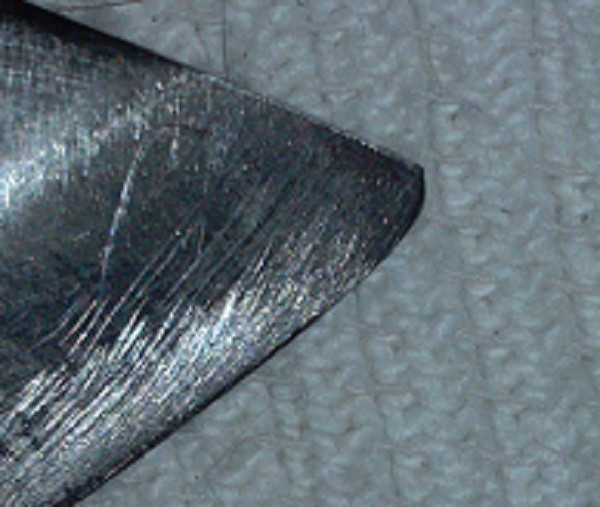

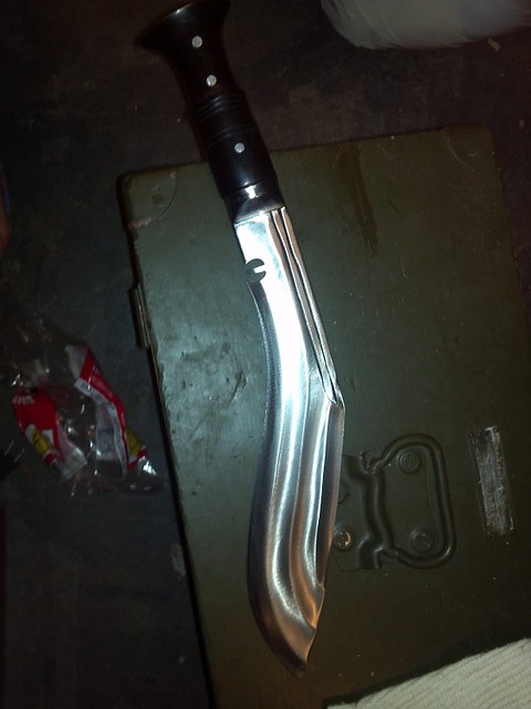

I received this kukri in the mail to find out that the tip was bent in transit. I went to the website and followed their advice on fixing the issue but as you can see the tip is still ruined. Any advice on how to fix it would be appreciated.

Well what i did is using a coarse inexpensive carborundum bench stone to grind the spine until i get a fresh but somewhat stouter tip . then i rounded the grind to match it with the spine curve.
You missed the / when you finished the image tag.
There is no "fixing" the tip...you have to reprofile it as stated. Be aware though...because of the way these are heat treated, you may find you don't have a lot of hard steel to work with. You may get the shape you wanted back, but having ground your way past the hard stuff and you now have a soft tipped khukuri.
Simply file the tip to shape. It's a lot easier and quicker that trying to use stones.
Yes i did get it from khukhuri House. Thanks for the image help Curtis_Lowe. If i avoid the grinder and use water stones will I be able to preserve the HT?
Dont use water stones. You'll end up grinding grooves into them.
