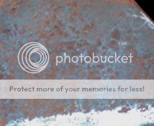

If you REALLY want to pit it, use Caseys Bluing and then dip in bleach, but beware it is etching on steroids and you are removing material.
This took about 25 minutes........Randy

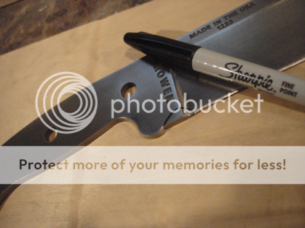

BryFry - what/how do you do the design etching on the hawk heads?
Using a lquid called PBC etchant that I bought at Radio Shack, it's use for etching circuit boards, but also works fine on non-stainless steel.
What you see in the picture above was my first attempt at it! I think with some practice one could achieve some pretty nice stuff.
There is a couple of good write ups on it in the middle of the "modding the CS Trail Hawk" sticky thread, but basically you cover the steel with a resist (spraypaint works great) then you draw or stencil your design by exposing the bare steel beneath the paint, then dip it in the liquid etchant.
The longer you leave it in the etchant the more pronounced the etching will be. :)
