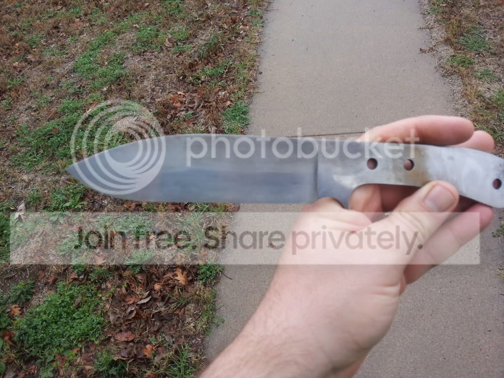

I am finishing my first blade in 1095. it has a very clear temper line/hamon from clay quenching. I think I ground it way too thin.
the blade is 5.25" long, 1.5" wide and 5/32" thick ground to a zero edge. I didn't mean to take our that far but it happened. I tested it by hacking a very hard mesquite log and don't like the results. about 3/16 of the edge bent and tore. it didn't chip as much as just tore. I tempered 2x at 2 hrs at 410.
oh, only about .5" wide was affected. please tell me that the edge was just too thin.
by the way, I normalized 3x, heated to 1450 and quenched in l8er
thanks,
Jason
Hey there Jason. I feel your pain. As said already, I would suspect your austenizing temp - even with a good heat series for the setup, you may have some feral carbon in 1095 quenched from 1450. Also, depending on soak time/atmosphere and how/when you took it to a zero grind, you may have a decarb zone, through and through, at that ragged edge.
If it were me, I would likely grind it back - cool and careful like - and test again. (Grind a new flat at .025" or wider and thin to centerline.) Either way, it's a place to start, you'll have learned something about your methods and may end up with a decent "Plan B" type blade (some of my best)...
It may seem like a mile, but you are close - real close.
Hang in there and keep picking away. Hope all is well buddy. AWL
I agree with Andy.
Grind it back ( at 1.5:" wide you have lots of room) and put a new edge on it . Make the new edge at 30-35° included angle. I bet it chops much better after that.
I don't see any big problem with your HT and temps, assuming you gave it a bit of soak time.

thanks everyone. 1450 is a little low. I'll try 1475 next time. I took the edge down to .013 and made a few chops in 3/4 plywood and it held up. this knife will be a wedding present for a friends to give to her new husband. I doubt he will be doing anything other than skinning deer but wanted to make it big enough to make it a general hunting knife.
I etched it last night with vinegar and will polish it tonight. seems to be holding up well now.

I have not ground it to a final edge yet. Still at .013 but did the brass rod test and everything seemed ok. I'll just have to guess that it was waaaay to thin for chopping on well seasoned Mesquite. Lesson learned.
