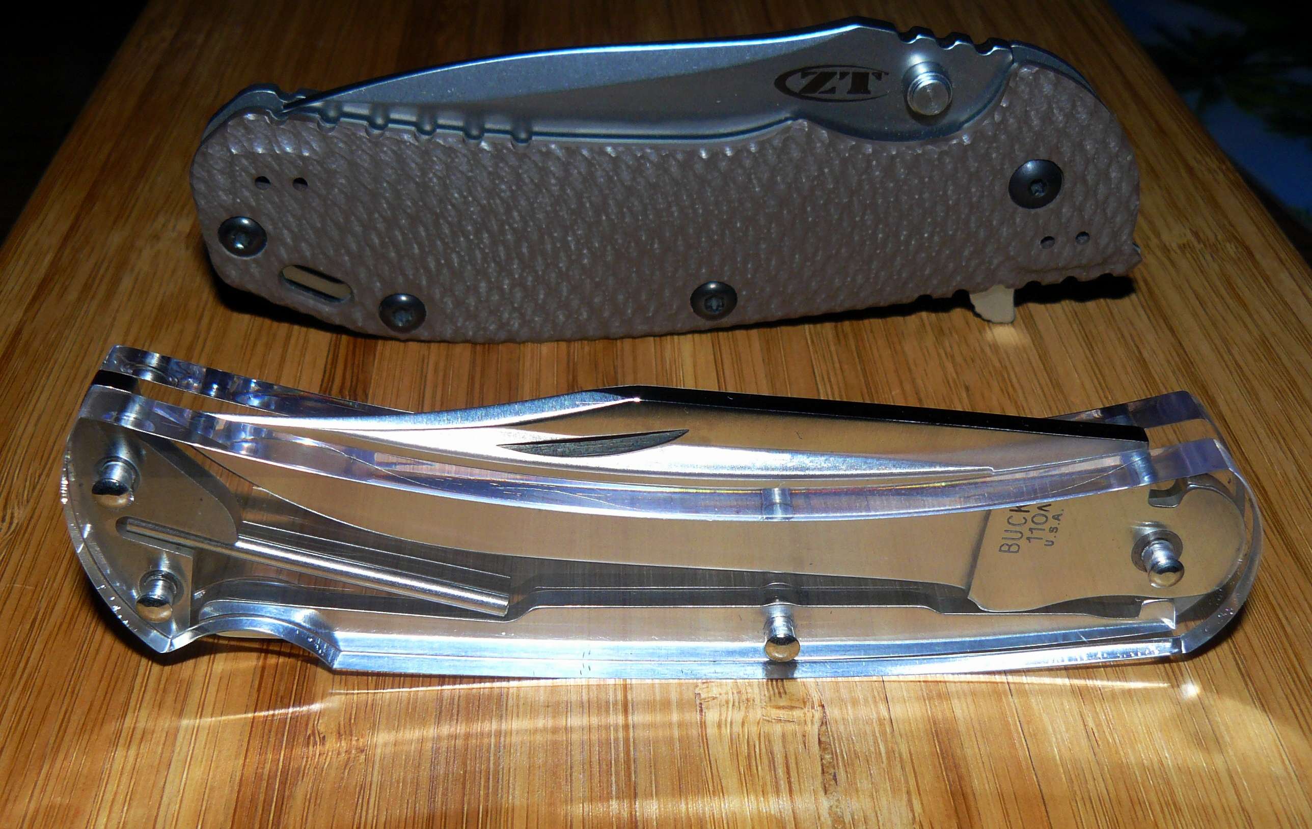

Oregon, that Buck is really cool! What are the scales actually made of, acrylic?

Pretty cool Oregon!
Thank you kindly. I am amazed every time I look at it.
That is sweet.
I agree. I keep it in the display case so I can look at it often.
It is the coolest scale material. 100% Bulletproof glass (composition of which is secret and proprietary) from scraps in this instance. Field tested with various firearms by the maker of the clear-handled folder Leroy Remer genius/artist/craftsman and a regular guy to talk with.

Thanks Oregon. That is really surprising to me, I would think that bulletproof glass would be really hard to work with but he sure pulled it off!
