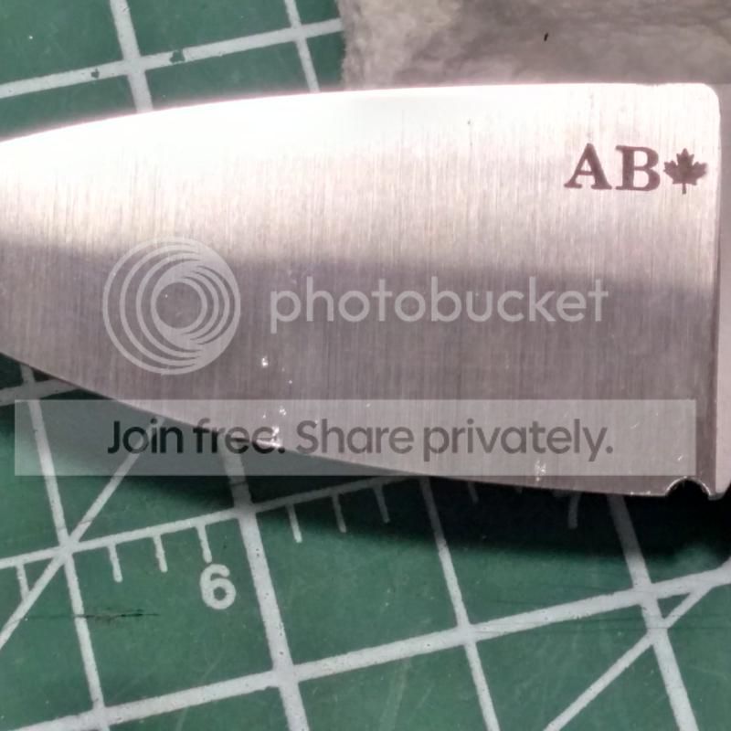

How could I fix this?
Feb 10, 2013
1,019
I was cutting off the excess pin material with a hacksaw and accidentally touched the blade with the teeth. I know I should have had it taped up but I was tired and not totally on the ball. Is there a fix for this or should I just try to sell it as a second? The finish is just from being flat ground at probably around 500 grit (maybe 700, I can't remember). Thanks in advance.
It doesn't look that deep from here. A few passes on the grinder should clear it up. You may have to bump it down a couple of grits first and work your way back up. Then etch your makers mark again.
