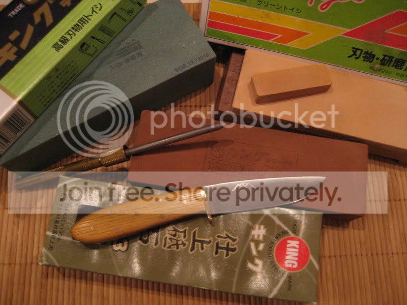

How did I miss these?
They do look pretty good. Not too expensive either.

I think these may just be the thing. I ordered a 4000 which most stuff says is equivalent to 1000 grit sandpaper, 1500 grit sandpaper being my most used so hopefully it will work.
Regardless I'll report back:thumbup:
I made my own small waterstones.
Start with a 1000 grit Makita waterstone, approx. 7" x 3" x 3/4"; score it on both sides with a used hacksaw blade; then cleave it along the score line using a wide brick chisel.
This makes a reasonably clean cut; the sides aren't perfect but it's pretty good.
I made 3 pieces from the large stone: one piece 2" x 3", and 2 pieces 5" x 1.5".
