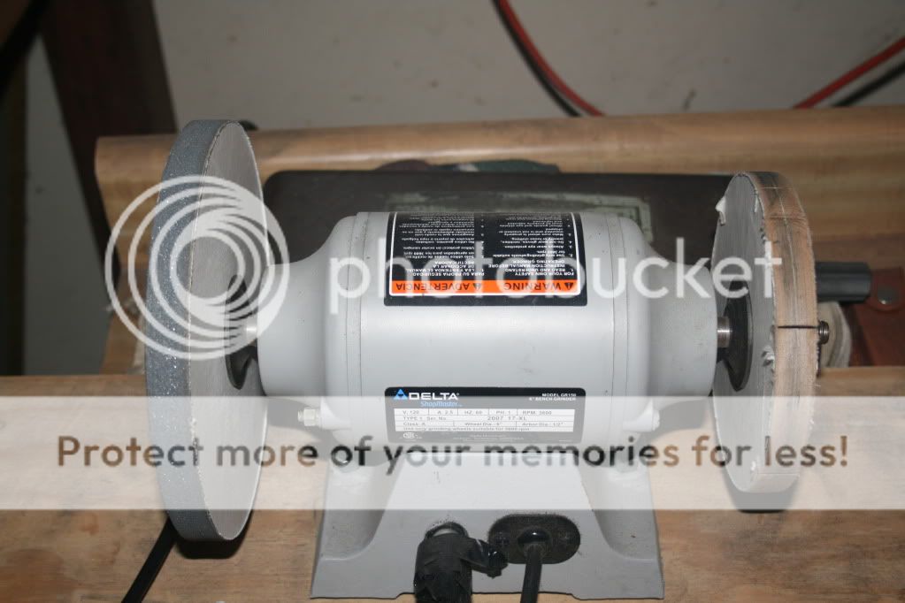

Here is how I went about it
Reason for 2 different size wheels I was in the middle of changing wheels when I took the pic
