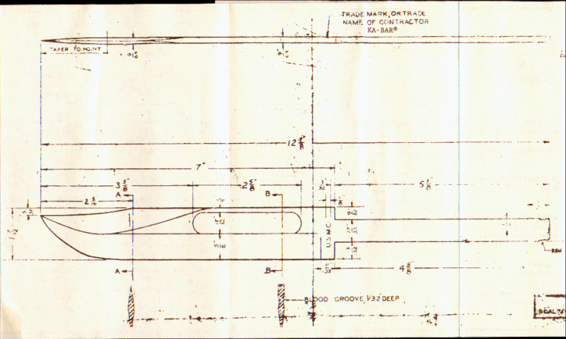

Here ya go;
Camillus Mark 2
Camillus Pilot Survival Knives
Muchas gracias, AL; another one of those "a picture is worth 1000 words" situations!!
- GT
Here ya go;
Camillus Mark 2

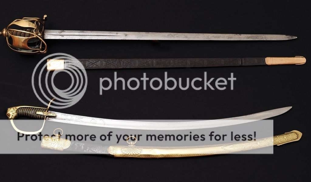

Is this really a myth ? .slender blades and most Daggers don't have them . slashing blades sutch as the cavalry swords don't have the them . back in the day their were put on large thick stabing weapons . I don't think this was for looks or whight maybe this is one for the mythbusters![]()

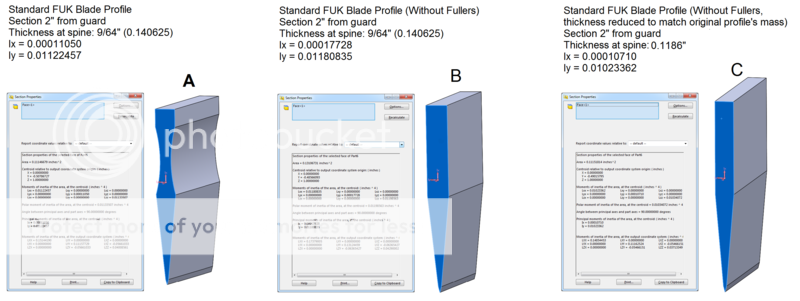

The Ix and Iy values represent the sectional moment of inertia (MOI) measurement in 2 directions. The Ix values represent the MOI parallel to the direction of cut (direction when chopping with a blade's edge), the Iy values represent the MOI across what we call the thickness of the blade (direction when bending a blade during prying). A higher MOI will directly relate to a stronger and more rigid beam when force is applied in that direction.
3 Blade Profiles:
A: Standard KaBar profile, 9/64 thick.
B: KaBar profile but without the fullers, still 9/64 thick. Note: this section has greater area (the knife would weigh more) than A.
C: KaBar profile but without the fullers, 0.1186 thick. Note: the thickness has been reduced to keep the blade weight the same.
Conclusions:
A: Standard KaBar profile, we will compare the other two profiles against these figures.
B: This profile has almost 18% more area than A. The MOI in the direction of cutting is 60% greater! The MOI in the direction of bending a blade is 5% greater.
C: This profile has the same area as A. The MOI in the direction of cutting is 3% less. The MOI in the direction of bending a blade is 9% less.
Conclusion: A fuller on the KaBar Fighting and Utility Knife slightly increases strength in both planes of loading (ONLY IN THE SECTION OF BLADE WITH A FULLER) over a thinner blade with the same cross-sectional area without fullers.

Most cavalry swords that I have seen have fullers.
Regards
Robin

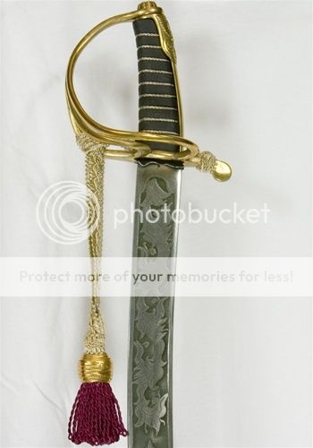

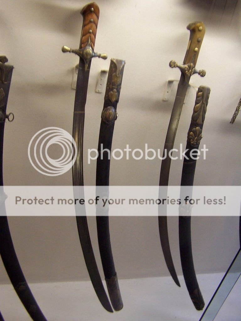

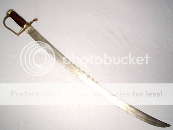

These are cavalry sword's from around the 16 hundred's . my be I should of said most . the point I was making is sometimes the is a little bit of truth in a myth . this is one that I would like to see put to the test . out of pure curiosity![]()
I would say some of those could be from the 19th century Napoleonic wars. My impression is that in a sword the fuller helps in having torsional rigidity in a cutting blade, but at the same time the blade can bend sideways in a cut. This helps in keeping the blade in on piece during cutting and parrying.
Watch this. See how the blade bends in the cut. https://www.youtube.com/watch?v=IDFPiF3xXCQ[/QUOTE..
You my be right I am no sword expert . you couldn't really tell whether or not the full cerved blade had a fuller . though it was evident in later cut and thrust sword .. But that's not the point the point is I would like I see it put to the test with a plan blade a one with a blood groove . I don't know what would happen . it would be something very interesting to find out![]()
