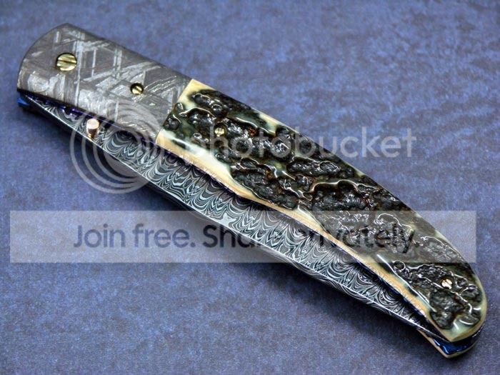

Steve, I have found ferric to work straight out of the bottle without adding water. Cliff Parker told me this and it works great.
I also used to etch in muriatic for depth, then a quick etch in ferric for color. Worked pretty good, but not as good as straight ferric.
Don, a lot the pieces that I have seen sold a jewelry or "sculpture" appear to be highly polished at some point in the process. I wonder if that helps with the contrast?
Joe, I've never been able to make it look good with any type of polishing, or high grit sanding after the etch. I do think some of the shinny stuff as a clear coat on it.
