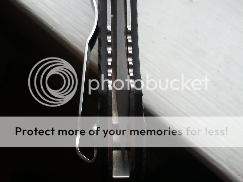

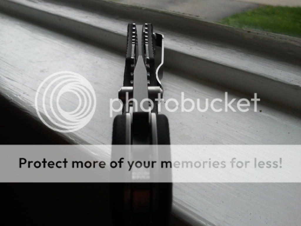

In the meantime, here's a couple of picture of the off-centeredness.

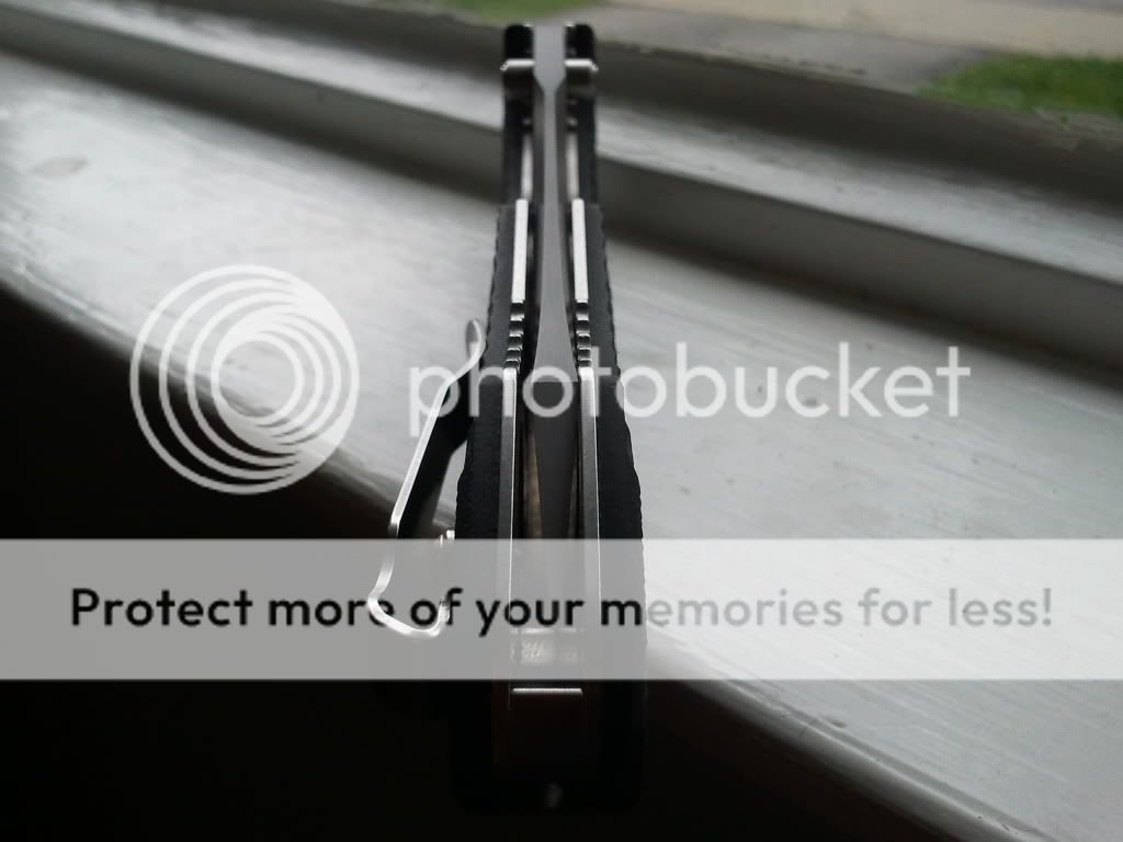

Here's another angle of the blade.

The blade does not look warped, it just looks off center. I have always tried the paper/take apart trick with good results, but never on a blade that far off! That might need to be sent in, that's a shame they let that leave the factory.
If you do have to send it in (which would really suck, I know) it will return perfect I think. Just be sure to print out the service form from their website and write exactly what you want done.
