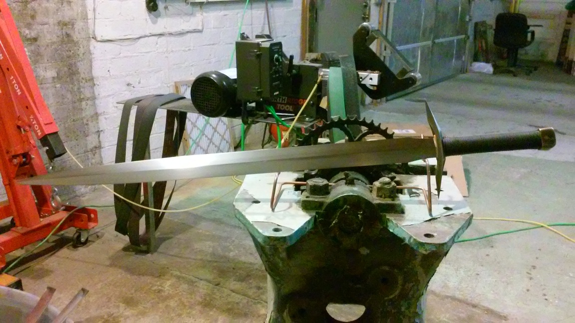

above is the body of a twist-core jian I am just finishing.
Fittings, half of all of the work goes into fittings. Plus, over half of the work is fine shaping, and polishing. You will want to come to know all the ways that one can use a file. No more valuable tool for a metal worker, and especially a swordsmith. EVERYTHING gets filed at some point when making swords or traditional guns.
