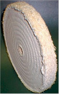

Those compound crayons are made to go onto wheels, not leather.
