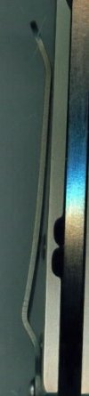

Now the next step is you make the bends. You can see the typical bend needed in a side profile shot (third pic left to right) and I know what you are thinking. How do I make the bends.

Don't be surprised if you break some clip blanks getting the hang of it. .040 thickness titanium can be bent without heating it but only so far. You'll know how far when one snaps off on you. Get the touch down you'll figure it out. Don't punish yourself over a couple breaks. Save the longer end of the scrap. You
can use those for practice bends to get better at the needed ummph.
Second bend is going to be down. This is where it gets tight. You will need the jewelers pliers here to make the second downward bend so as to be able to do so without affecting the first bend. Grab with the left hand, place where your secondary bend will be and using the duck bill vise grip the other side of your line. Now bend gently but forcefully down to make the clip yield to your will. Sounds easy. Its not. If your left hand does not have the strength with the glove on you can use a smaller cresent wrench with the handle clamped firmly in a wood vise on your work table so that the adjustable end is out just gapped enough to fit the clip in where you had your pliers.
Then you can move down to the last bend which is going up again. This is the bend where the folder slides down over the rim of the pocket at the bottom of the clip. Using the duck bill pliers and either the jewlers pliers or the cresent gently bend up with the vise grips.
Practice making bends in the metal or titanium scraps left over from your breaks until you get the hang of it.
