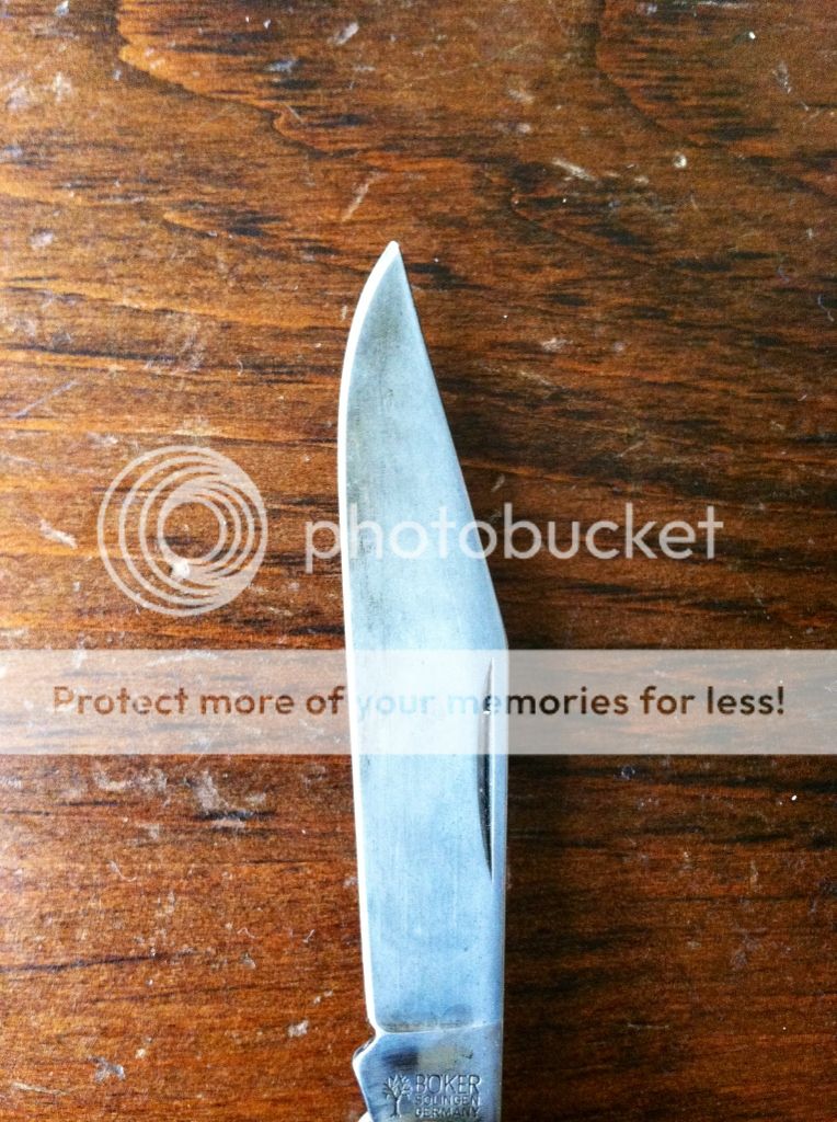

The first I bought was a Henckles congress with carbon blades. I like it, but one of the scales is concave and it is a bit bulky in the pocket for me. Then I bought the ever popular peanut (SS in Amber bone)and a Buck cadet. I sharpened both and carried the cadet for a couple of weeks and then gave it to my daughters boyfriend (not because I didn't like it). Now I'm carrying the peanut. I do like it, but I also really like carbon better. So I ordered three carbon knives yesterday, #1 is the yellow cv peanut! #2 is a hen & rooster whittler and #3 is a boker tree carbon whittler, both the whittlers have etching, which I'm not really all that excited about. What is the best way to remove this etching? Can I just sand it off with wet/dry sand paper? I haven't received these yet, so not sure what to expect. If anyone has any info/experience removing the etching I would appreciate it.. also any other comments on the hen & rooster or the boker I would appreciate those as well.
And because I know we all like a picture:

iahunter: The knives you ordered are made of carbon steel. What I always do with carbon steel blades and etchings (if I don´t like it), I just let it overgrow with patina and that´s it. You could also use polishing compound to remove the etching.
Hope this could help.
Kind regards
Andi
Thanks Andi, I didn't know how deep the etching would be. If polishing compound will remove it, it will be removed asap.. I would prefer a pristine blade, before I start using it and scratching it :)
I've had good luck using Flitz paste polish and a soft rag to remove blade etching. Might take a couple applications, but after you're done the patina will further eradicate any trace of original etching.
I'd also just go with polishing paste (Flitz/Simichrome). Using it with a buffer or Dremel and a cotton wheel might speed things up a little. Some etches will be deeper/denser than others, and it might hang around for a while. But over time, with an occasional polishing/buffing, the etch will get lighter and lighter. I wouldn't try to rush the process by sanding, as the scratches left might be more of a disappointment than the etch itself.

Boker is great I've had this Boker stockman for about six years and used it at work paired with a Opinel and it is one of my favorites, Bokers carbon takes a wicked edge and it is also flawless. Mine had a etching on the clip blade and you can't see it anymore, also your Henckles congress is most likely made by Boker unless it is very old, also Boker makes H&R, you should be very happy with your choices.

I have a Case CV Amber Bone Canoe and to rid it of the etch on the blade I just forced a patina on it with vinegar after sanding it with sand paper and that sorta covered it up but if you look pretty hard you can still make it out. I suppose I just didn't want to get carried away with the sanding.
I tried to get rid of the Canoe etching as well, managed to polish the ink off, but the etching is deep...

GEC black etching is so fragile it almost seems to have been done with a
felt pen; simichrome and a little rubbing will take it off almost right away.
Laser etching you're stuck with unless you are really determined--still
don't like to think of sandpaper or steel wool...
2nd or 3rd for flitz. It's fast and safe. Also, what's up with GEC etches they are honestly gone in 60 seconds of use??? My Ben Hogan logo turned into B an so I just polished it off...just weird they didn't go more permanent for the PPPs, etc.
