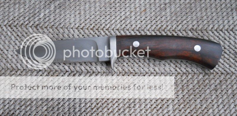

I did the acid wash on this Larry Page hunter of mine. It is CPM154 and was a mirror finish when I got it. I just used the good old ferric chloride PCB etch solution from Radio Shack. I've done this to a number of non stainless blades as well (1095 and 3V). This is the only stainless I've tried but it turned out well.
Very nice. How did you make it that even? A soak? Sometimes I think I get a greenish tinge from PCB etch.

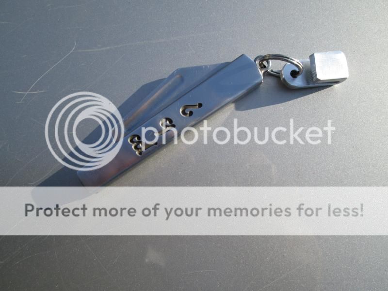

When I engraved this thing with the Elvish script it ended up pretty rough in the bottom of the engraving. I filled the characters with PCB etchant and let it sit for a long while to camouflage that.
I wish I knew what acid they used in metal etching pens. That gives a nice black color. The best you can get from Ferric Chloride is a light grey.
