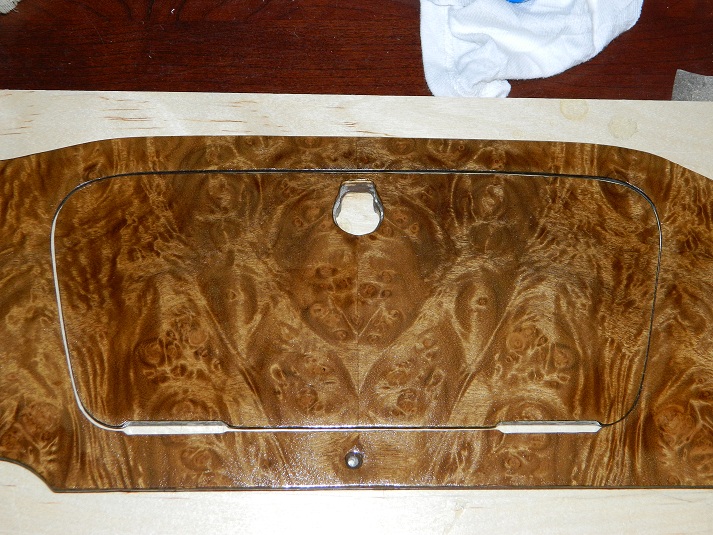

The best finishes I've found to preserve and really make the chatoancy of a fine wood stick out are, as mentioned above, oil finishes. This wont work for real dense / oily woods like cocobola or lignum vitae, but for things like maple, sycamore, yew, etc it works great. I've just had very good results with Formby's Tung Oil Finish (low gloss), which is a tung oil based rub-on varnish (NOT a pure tung oil) when doing a highly figured burlwood veneer dashboard.
It's very hard to get a good photo of chatoyance, since the effect depends on the movement of light over the object, but this was my best attempt to get a shot of the glove compartment door for my dashboard with that finish.
edit: spelling > me
