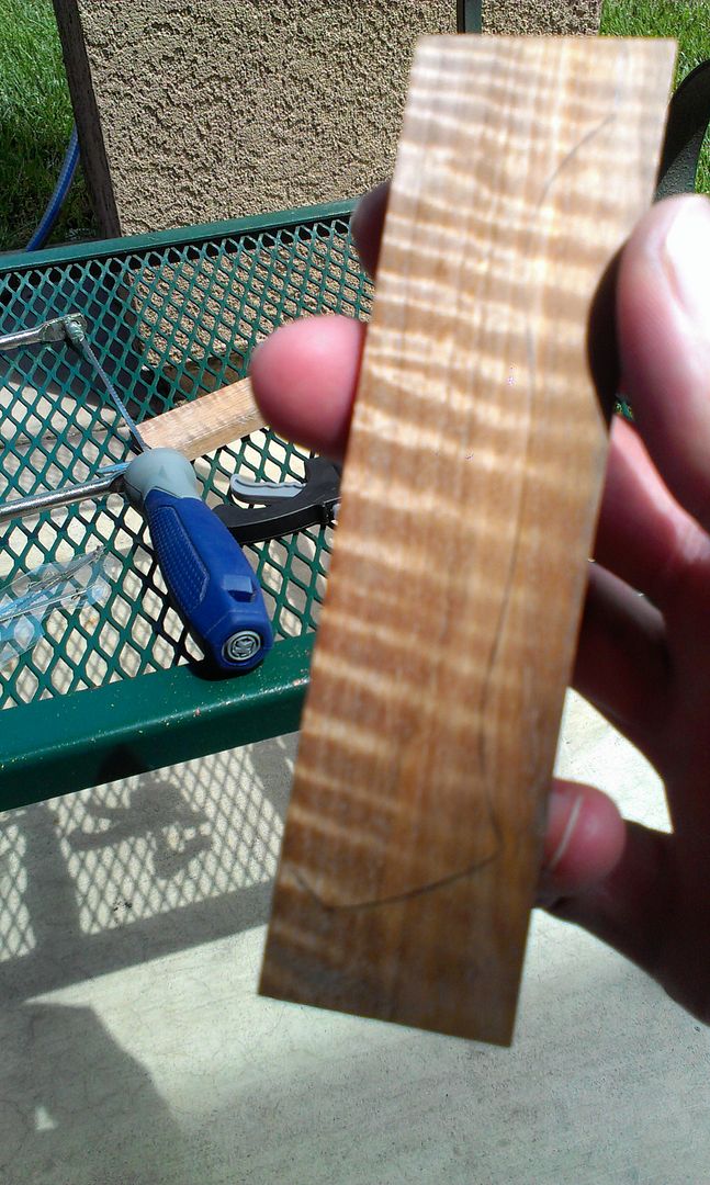

Also, I'm using very nice stabilized wood. Now that I'm starting to shape them, how do I get the luster/figure back?
Here are a couple of random pics.
Pins and tube.
Wood.

You should drill the scales first, then mount them along with the rivets and tube all in one step. The rivets/tube should stick out a bit past the handle when gluing up. I usually go about 1/4" extra per side.
Make sure you "clock" the rivets and tube so the pattern is right. The square should be set as a diamond, with a corner at 12:00. The tube isn't as finicky, but either make a black space at 12:00 or put a round pin there. If the rivets/tube are off even a little, it will stick out like a sore thumb.
Gotcha. What do you use to cut the stuff?
Also, I've had trouble in the past with wood/micarta/whatever sinking below the level of pins when trying to surface grind them. How do I avoid that?
Cut them with a hacksaw that has a 24TPI blade.
After the glue is fully cured, saw off the stubs and then file them flush with the wood. Use a wooden block as a backer when doing the final sanding over the pins.
